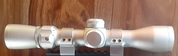

Bushnell 2x6 handgun scope
Coloradoyaler
Saturday, February 11, 2023, 13:44 (1366 days ago)
I am looking for experience and opinions on whether or not this scope will hold up on a 500sw?
