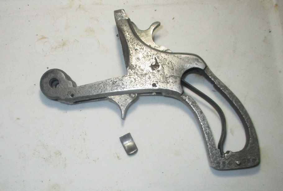

I installed the mainspring and then put the trigger group together and put it in the gun and tried the double action pull. It felt mushy but I kept pulling slowly and found out why it felt mushy. The trigger broke off!
![[image]](images/uploaded/2023022421435563f92f9b6a508.jpg)

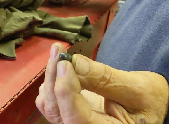

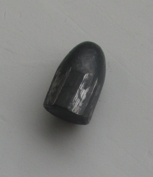

So I went back to the guy on Ebay and sure enough, he had a trigger and I bought it. I received it today and this afternoon I went out to the shop and installed it. Once I had it working I decided I wanted to shoot it. I trimmed a .38 Special case to the length of the .38 S&W, primed it and dropped in 1.5 gr. of Bullseye. Then I pushed a 124 gr. Bear Creek 9mm bullet into the case. I did not crimp it. I laid some rags on the tool box and shot it into the rags and recovered the bullet.
