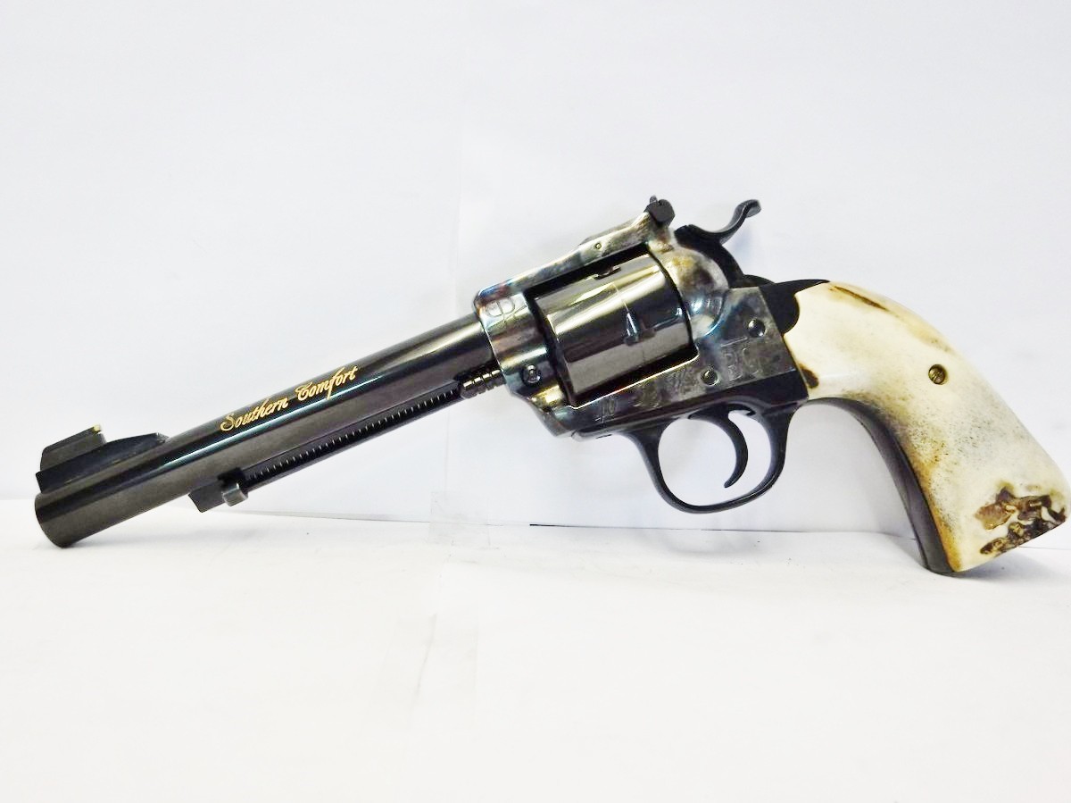

![[image]](images/uploaded/202303032230366402750ca98c7.jpg)
What's the best base gun for Trail Gun?
- Keith, 2023-03-03, 15:25
- There is no difference in the 7 shot or the 6 shot - Gary Reeder, 2023-03-03, 16:46
- I'd figure much easier to start with centerfire - WB, 2023-03-03, 15:32
