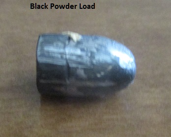

I fired all 4 rounds into a 2x4, spacing about a foot between the shots. I then measured the depth of penetration of each using a Browne and Sharpe dial caliper.
12.0 gr. Goex Black Powder
case sized in the .38 S&W die penetrated .540" to the base of the bullet
case sized in 9mm die penetrated 1.07" and broke the rear side of the 2x4

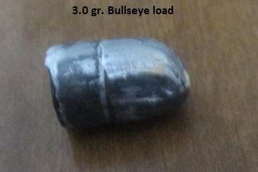

3.0 gr. of Bullseye
case sized in the .38 S&W die penetrated 1.109" to the base of the bullet
case sized in the 9mm die penetrated 1.487" and would have exited if it had not turned sideways
