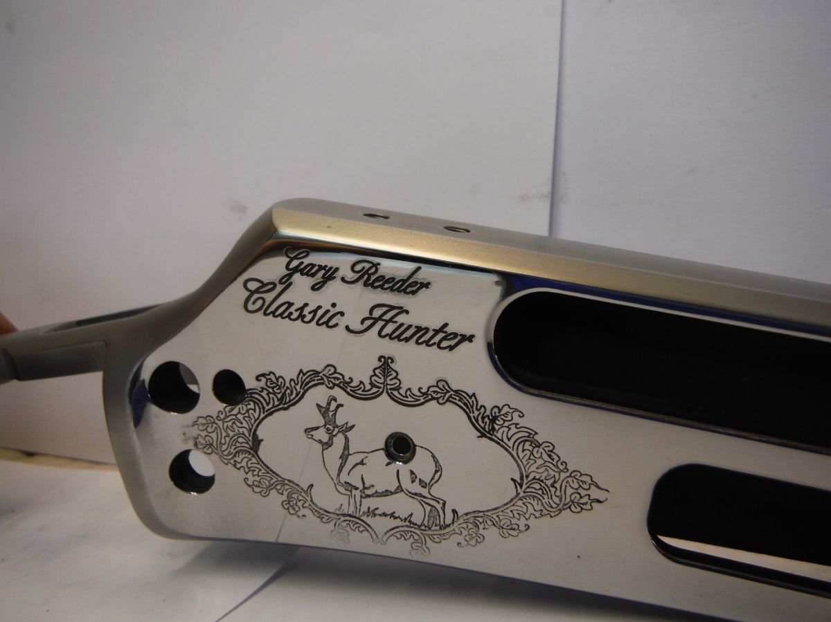

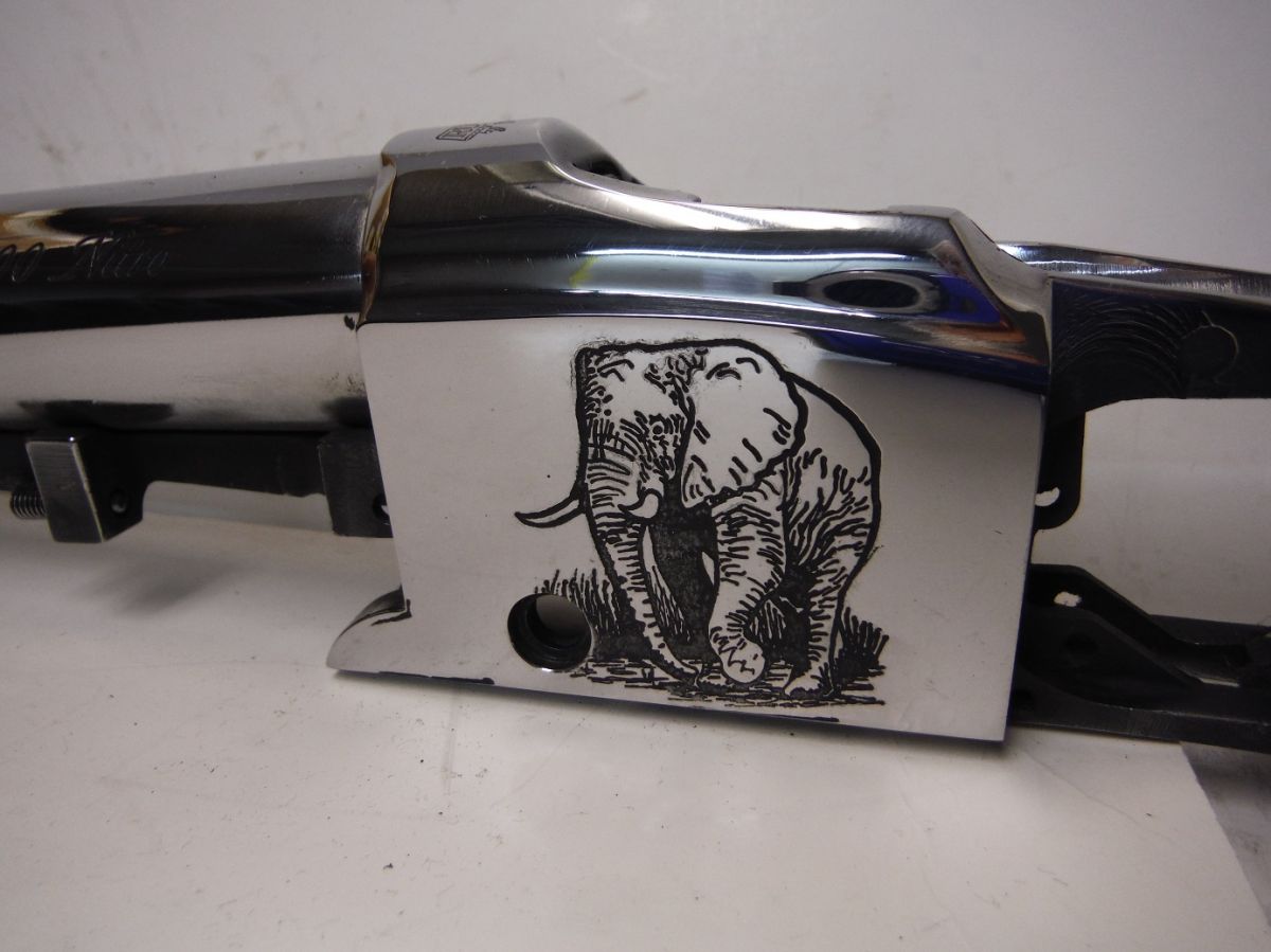

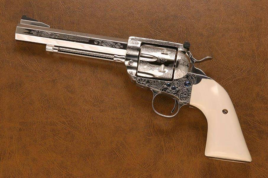

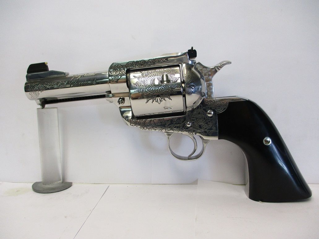

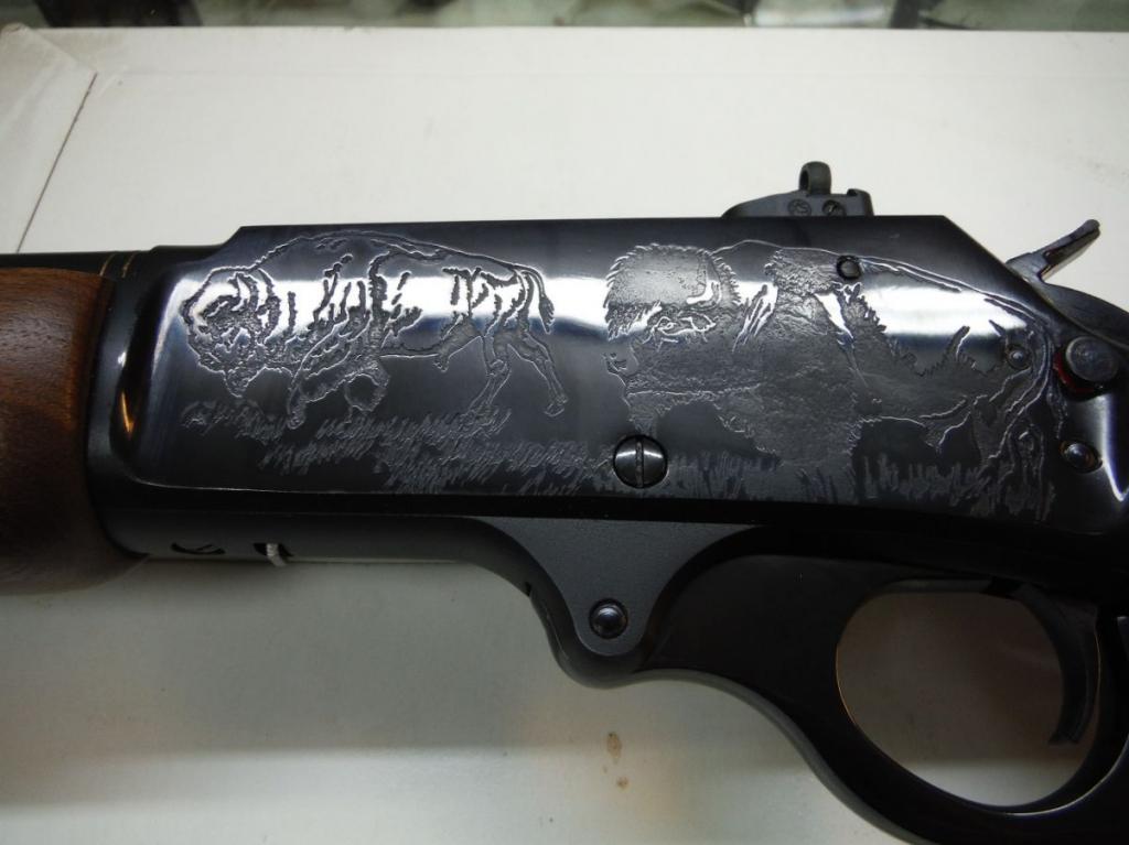

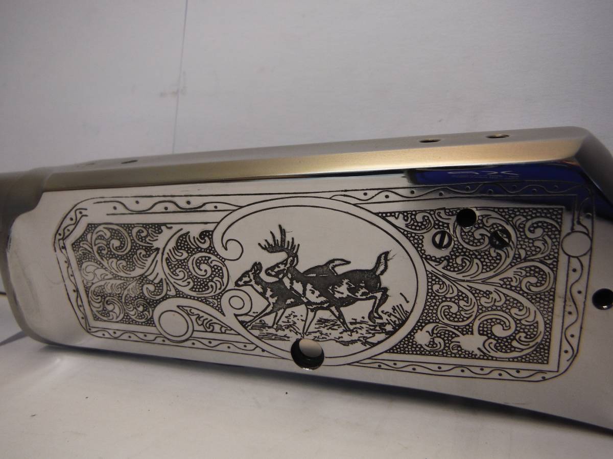

Our engraving is similar to the CNC type engraving except I do it pretty much by hand. I use a template using acid to etch the design into the piece of metal, a cylinder or 1911 slide or whatever. Then I use an electric hand engraver that goes back in and traces the design. So yes it is hand engraved but it is not the old original hand engraving with hammer and chisel. I can full engrave a gun like a couple of #5s shown here in about 2 to 3 weeks. But if I had to do it with a hammer and chisel (which I am not talented enough to do) it would take me several months to do the same engraving. And cost about 4 to 5 times as much.

I have to measure each part of the gun and then draw up a template with the design the customer wants and send it to my template folks. They do the vinyl template and get it back to me in a few weeks. That is what is used to put the design on the gun using acid that I can go back in and trace over with the cutting tool. Quite often I get a customer that wants a full scene and that takes a lot longer. I am doing a scene with a bear on a ledge looking down at an elk. I first put the mountains and trees in, then put the bear on a rock and then put one or two elk down in front of the bear. Each scene has to be measured so I know how much room I have to work with. It is time consuming but it gives the customer what he wants and doesn't cost him a fortune. These gun parts are mostly finished with a bit more work to do in polishing and touching up a part or two. And each piece except the last one are raw metal in the white.
