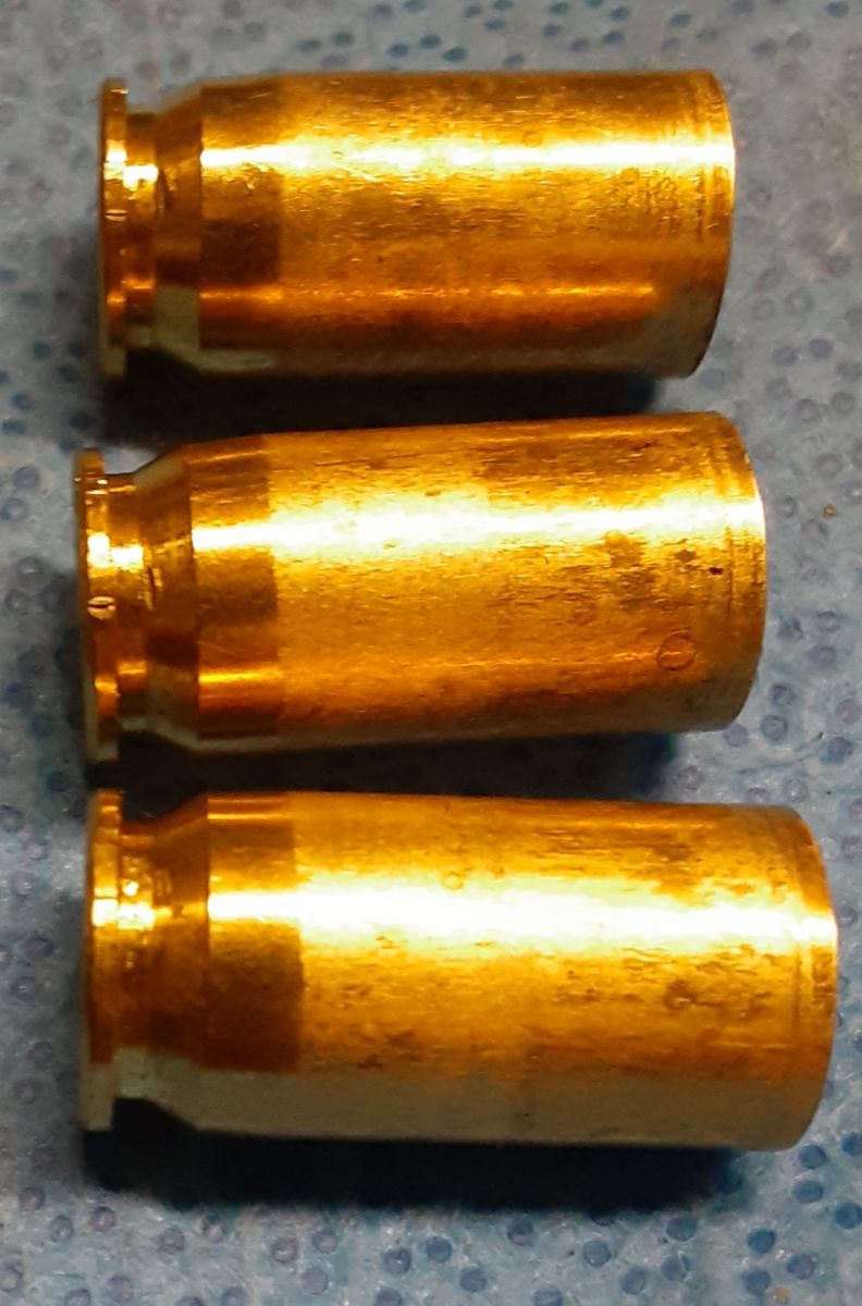

I have never owned a 1911. So I picked up a Springfield Garrison in 45acp. I bought a 460 Rowland kit for it in which I installed. Went to range to test it. I usually reload but decided to try some buffalo bore ammo. Shot some and it function fine. So I decided to put low profile adjustable sight on.The factory novak was extremely tight but I got it off. Put new sight on and went to range. The gun fires but leaves spent case in chamber. I can extract cases working the slide by hand. But it doesn't when fired. ANY help is appreciated.

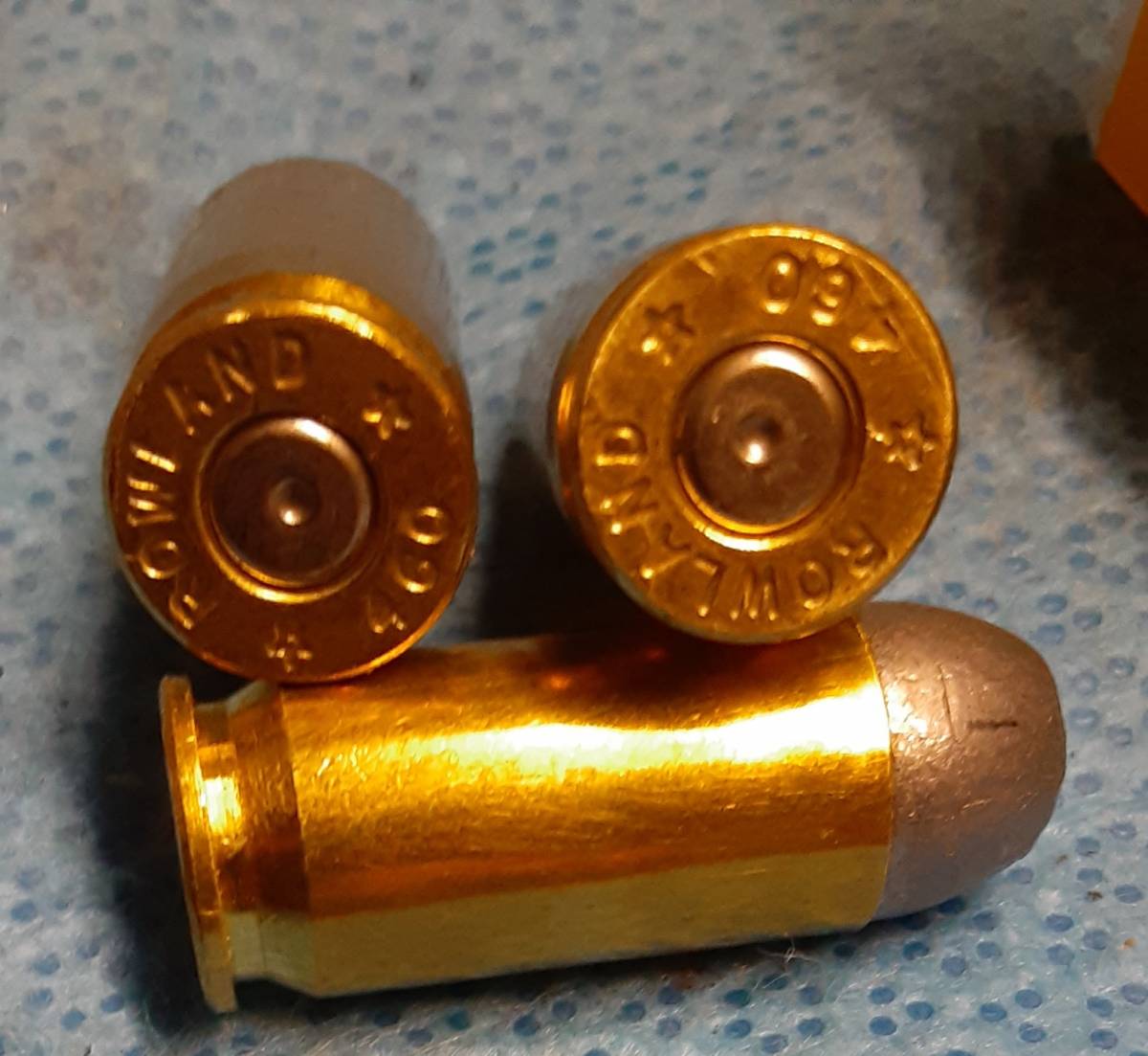

I have seen “factory” ammo loaded so hot the primers flow back into the firing pin hole! My guess is either the extractor has a problem or the round is so hot it’s sticking in the chamber and the exterior can’t pull it until the round cools a tad longer than it takes the slide to cycle. What pound recoil spring are you using? And look at the primers on your fired case’s. See if they are flat or have a spur from flowing backwards. Need to see a dent to be sane in my book.

What do the primer’s look like? Are there extractor
Blake
Sunday, May 28, 2023, 03:56 (1260 days ago) @ Coloradoyaler
Marks on the fired case?
Buffalo bore 230gr and 255gr
Coloradoyaler
Sunday, May 28, 2023, 07:42 (1260 days ago) @ Blake
Extractor marks

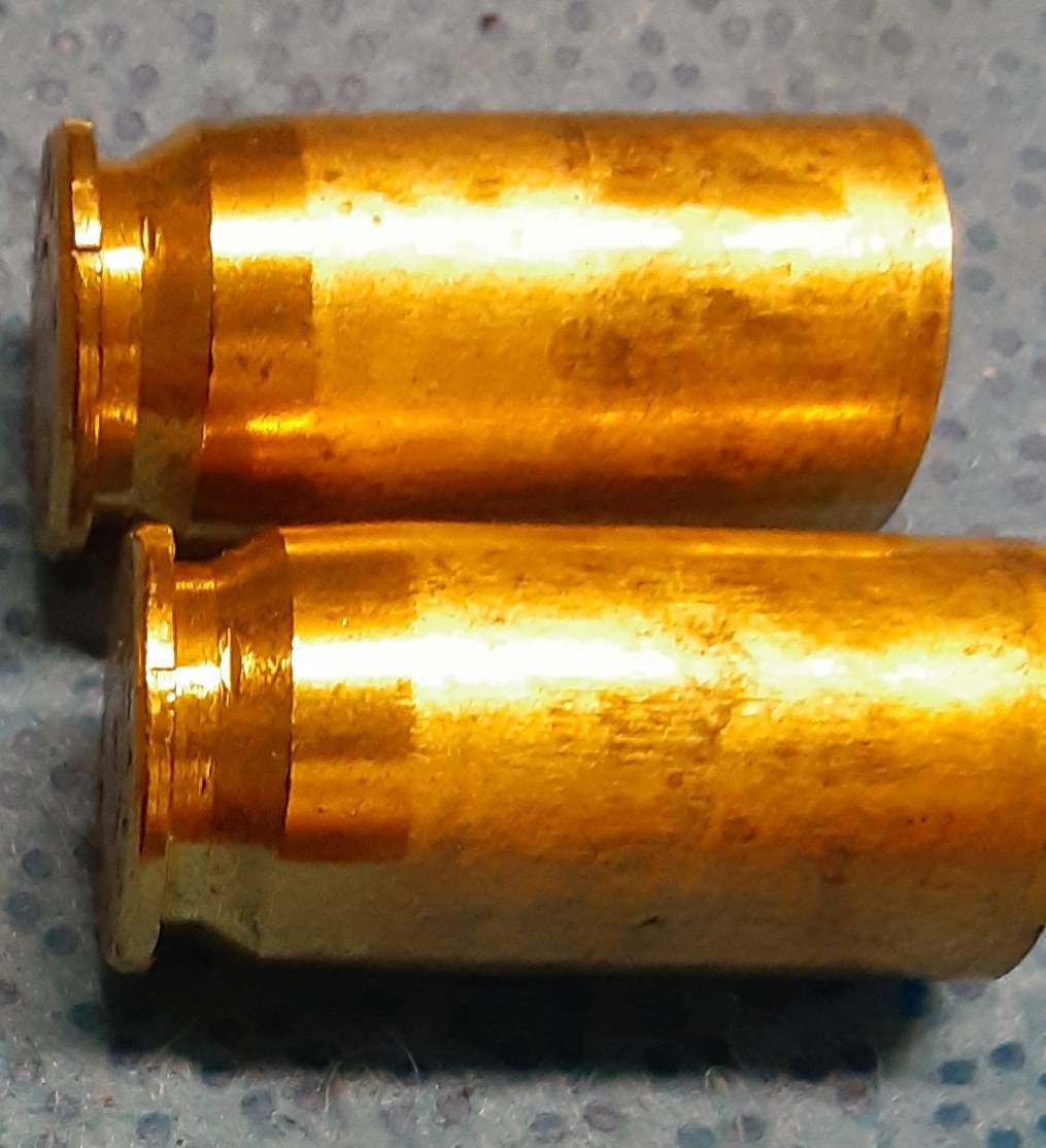

Coloradoyaler
Sunday, May 28, 2023, 08:55 (1260 days ago) @ Coloradoyaler
Looks like the extractor is denting the case
Blake
Sunday, May 28, 2023, 11:00 (1260 days ago) @ Coloradoyaler
Under recoil. And it has a drag mark where it skidded over the rim. I would guess it is not sitting deep enough. You should get one of Gary’s 1911

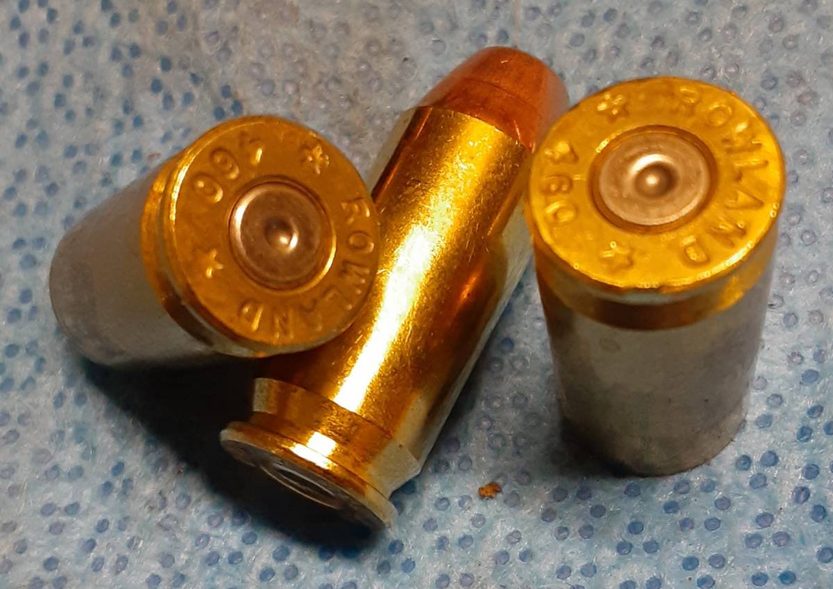

Extractor Sounds Likely
Revolvers&1911s
Sunday, May 28, 2023, 16:29 (1259 days ago) @ Coloradoyaler
I have been shooting the .460 Rowland for years and primarily reload for it. If your cases are staying in your barrel and not extracting I would believe that the slide is coming back with more force than the extractor you have can handle and it loses its grip on the rim of the case. I haven't had this happen personally on a .460 Rowland 1911, but it did happen to a .45 ACP RIA I had. No kidding, my gunsmith bent it forward just a little bit and the problem disappeared. I'm wondering if what happened was that the first few rounds didn't stress the extractor too much but then it lost it's grip. Let us know how the extractor works out if you swap it out.
