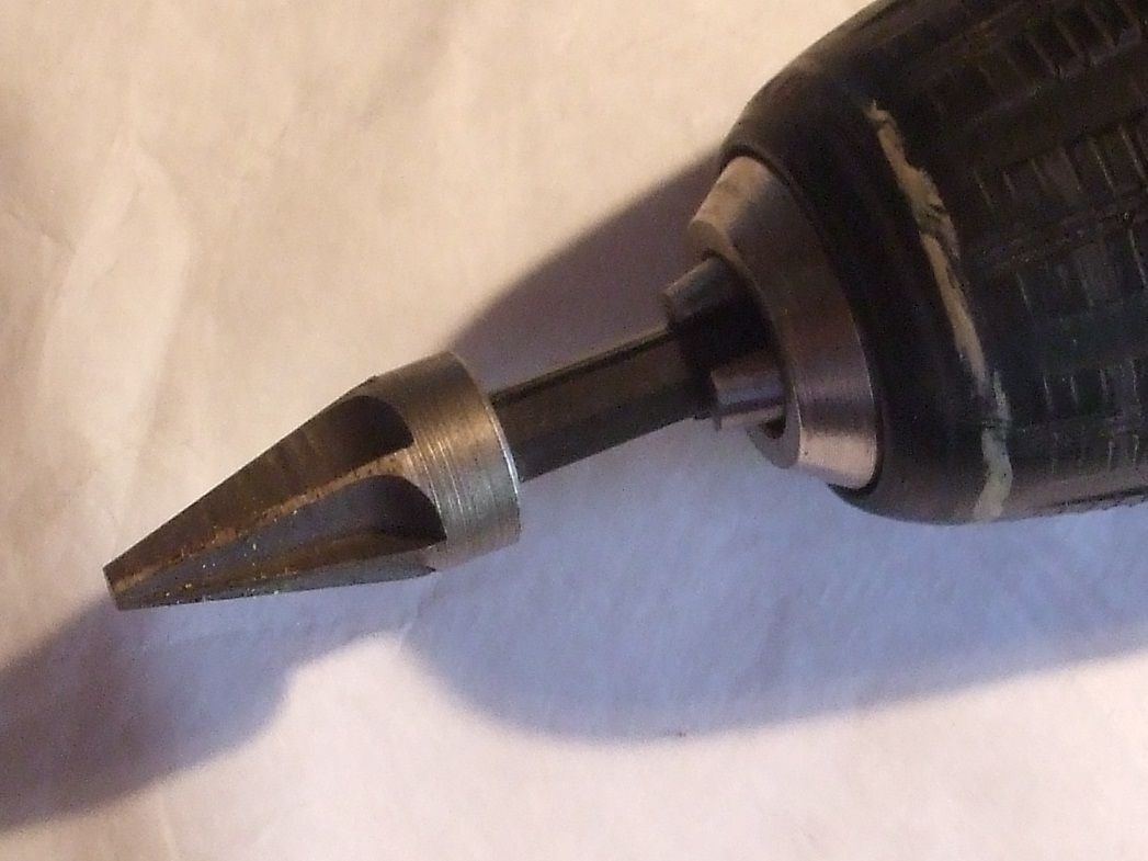

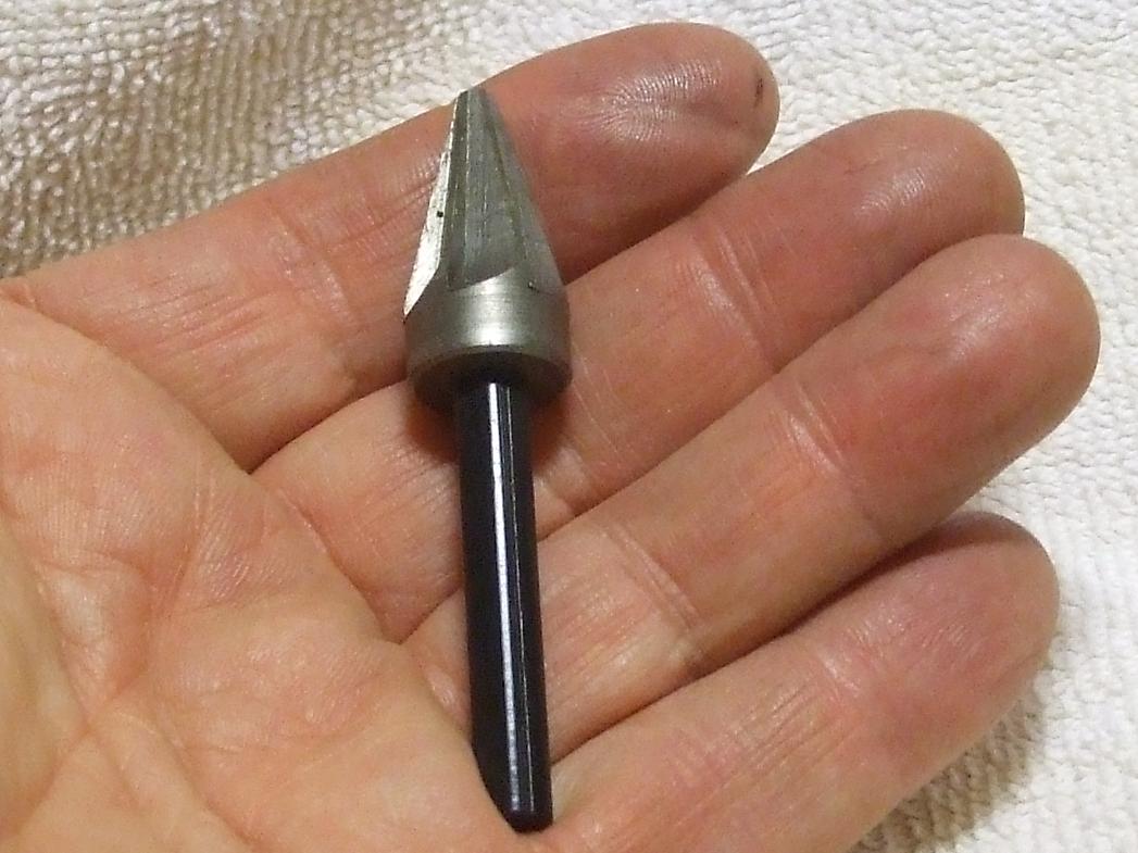

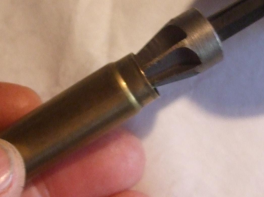

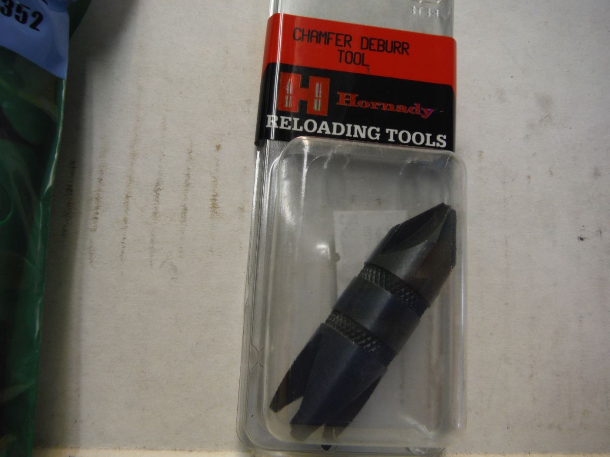

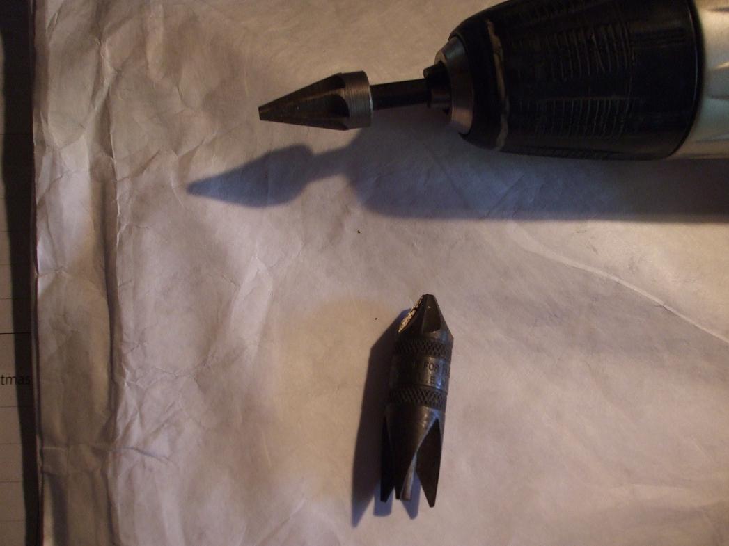

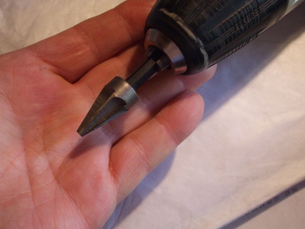

On the short neck cartridges do not use
Wednesday, July 05, 2023, 17:46 (1220 days ago) @ carl hackney
the middle die, the expander die.
Just barely touch the mouth of the case with a neck chamfering tool, This allows the bullet to sit in the mouth of the case without expanding the neck of the case.
![[image]](images/uploaded/2023070600420464a60ddcd53ef.jpg)
![[image]](images/uploaded/2023070600422564a60df1355b2.jpg)
![[image]](images/uploaded/2023070600424164a60e01bfcf0.jpg)
About a second in the mouth of the case, just enough to shine the mouth of the case will do and leaves the tension in the neck of the case.
The electric tool or the manual hand held tool will work.
