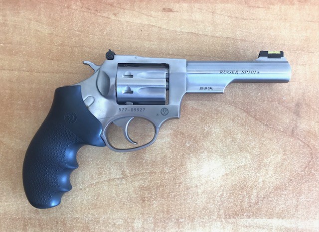

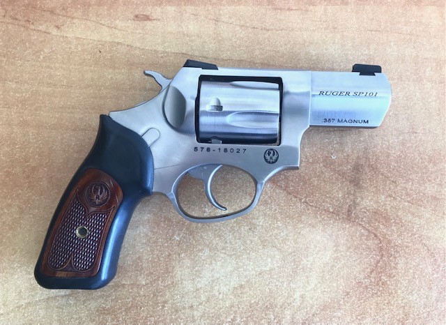

It's for the SP101's in my collection. Absolutely horrific factory trigger pulls and rough actions. SA is tolerable at maybe 5-6 lbs and pretty clean break but the DA is maybe 12-15 lbs.? The .357 I plan on keeping. Even though it weighs more than a G19 and only holds 5. It just feels like it is well made. Handling it you think "Yes, this is nice". I figure a basic lightening of the return spring and mirror polish on the bearing surfaces will suffice. Now the .22 is another kettle of fish. It is a very nice trail gun, no doubt. It's heavier than my M63 'Smith, but more accurate and has better sights with 25% more capacity. I'm a bit concerned about lightening the hammer spring as I don't want any rimfire light strikes. I think one could get carried away pretty fast. Mostly the gritty pins, through holes, and trigger return spring seem to effect a good quality trigger release. Sure the light hammer spring makes it easier to cock and the DA pull lighter some. But how much precise DA shooting do you really do? I'd take feel and reliability over pinky pulls anytime.
