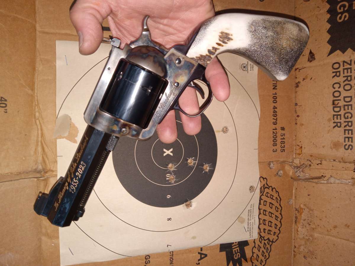

Well my first shots were today.
475BISLEY480
Friday, November 10, 2023, 16:04 (1091 days ago)
But I actually lost my front sight retaining screw under recoil.[image] Could someone please send me a link to where I can buy one?
They are special screws. I will send you a couple.
Friday, November 10, 2023, 16:11 (1091 days ago) @ 475BISLEY480
Check them and the other screws every now and then as they vibrate loose and are lost.
Oh okay awesome thanks for sending me one or two!
475BISLEY480
Friday, November 10, 2023, 16:17 (1091 days ago) @ Gary Reeder
I guess I will blue lock tight it in when I receive it?
You can use Lok Tite or just some clear
Friday, November 10, 2023, 16:20 (1091 days ago) @ 475BISLEY480
finger nail polish will work.
The screws were in there when I did the final test
Friday, November 10, 2023, 16:19 (1091 days ago) @ Gary Reeder
firing of the gun. We always check them as they will vibrate loose. I put a bit of Lok Tite on my guns so they don't come loose. I will get a couple of extra screws out to you tomorrow.
The gun shot a very decent group in the final test shoot. It was about a 2" group at 25 which is excellent for a large heavy recoiling gun. It took me about 10 minutes to shoot that group. Shoot 2 rounds, put the gun down and shake some feeling back into my hand. Then shoot 2 more. Etc.
Alright good deal I'll do just that good shootin right there
475BISLEY480
Friday, November 10, 2023, 16:49 (1091 days ago) @ Gary Reeder
Yeah, man that’s a tiger by the tail!
Friday, November 10, 2023, 20:16 (1091 days ago) @ 475BISLEY480
Being an ultra high performance platform some fiddling is sometimes needed. Like a dirt bike you can jump the house with, check things after a robust ride! You are flying closer to the sun than most. Depending on your specific loads you may prefer a taller or shorter front blade etc. GNR has those in varied styles. I keep a selection. Check the ejector tube retaining screw, cylinder pin retaining cross pin assy. Of course the frame screws occasionally. You know this but invest in the proper type of driver bits so not to booger the heads. I like the blue loc-tite myself. Comes loose without heat. Red requires heat and green is about chemically welded!
