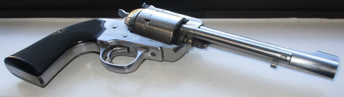

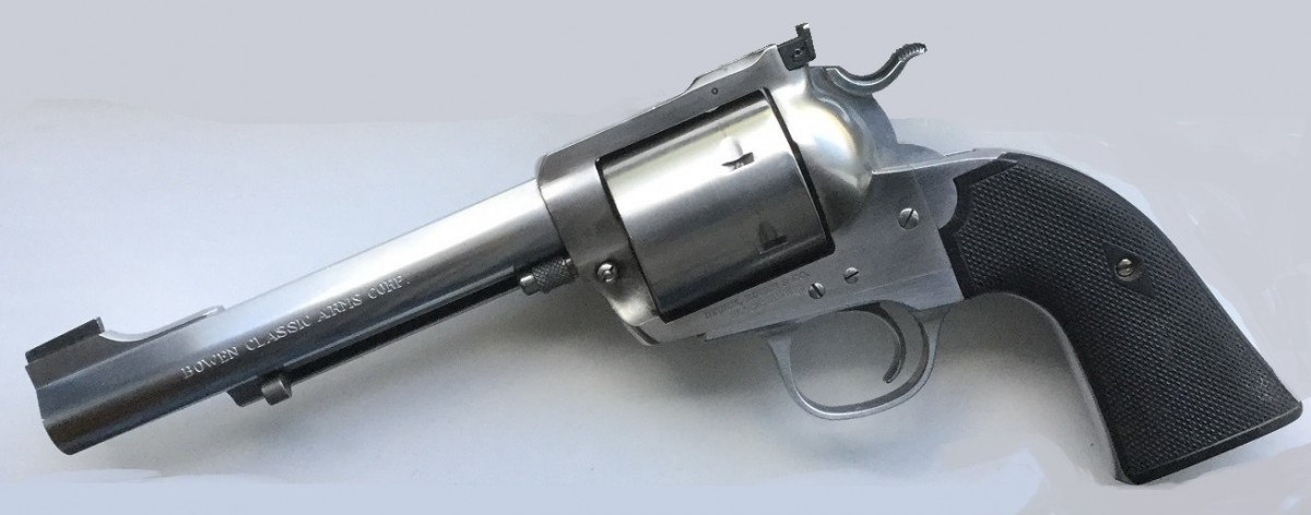

When Jack talked to Hamilton Bowen about the gun he told him that he wanted the gun to live again, but not as a .44 Magnum. He wanted it brought back as a .41 Magnum. Not only that, he wanted the gun accurized and he ordered special work to be done on it. After they had talked over what was to be done Jack sent the gun to Bowen Classic Arms and they began work on it. It took some time for this was no “rush” job. Everything was done right! A new barrel, a new cylinder, new lockwork to replace the worn originals, tuning the trigger and more. The fitting was tight and smooth. Internally Bowen added some of his own things such as a block that keeps the cylinder bolt from hammering on the frame when the gun is cocked rapidly. Bowen's own designed sights were installed, front and rear. He made the barrel his “ovate rib” design that tapers 3 directions, looking round from one point of view and almost octagonal from another. His own cylinder pin designed not to pound the cylinder latch during heavy recoil became part of the resurrection. The barrel was “Taylor Throated” for extreme accuracy. The pins that go through the hammer and the bolt were slotted on the left side to give the appearance of screws. With the block that Hamilton installed for the cylinder bolt, from the left side the gun appears as a “3 Screw” model. A set of yellowed Micarta stocks by Charles Able were fitted to the gripframe. The gun received an overall high polish externally and it shined again!

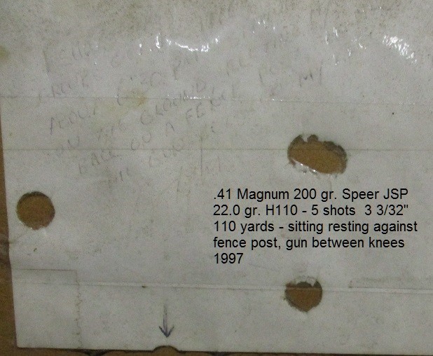

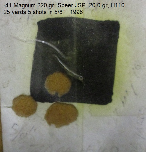

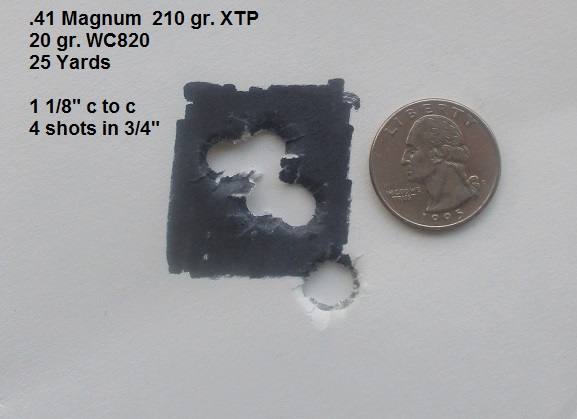

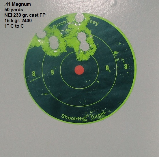

I had never messed with the .41 Magnum cartridge and had maybe shot 5 or 10 rounds from one in years past. Once I was home I began shooting it on my Range and found it to be The Most consistently accurate revolver that I had ever shot. From a rest at 25 yards groups under 1” center-to-center of 5 shots were common. Many groups were around 3/4” center-to-center with some as small as 5/8”. Sitting on the ground, resting my back against a fence post and holding the gun between my knees, I fired a 5-shot group at 110 yards that measured a bit over 3 1/8” center-to-center. (I miss young eyes!) If I worked on my breathing and trigger control the gun just did not miss. I missed with it at times. But it wasn't the gun's fault. And over the years it became my Number One Hunting Gun.

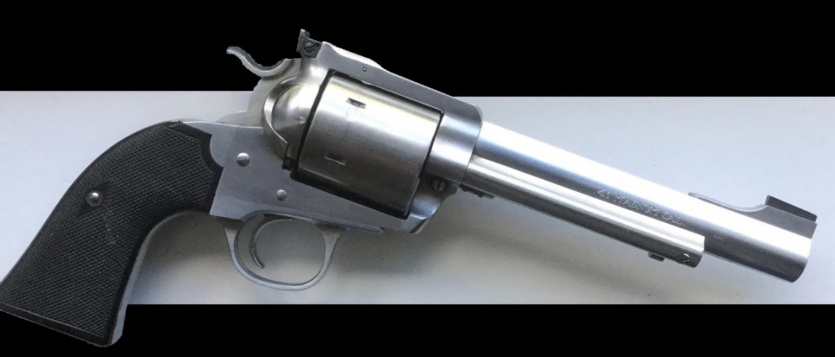

But … I did not like the Super Blackhawk grip. The big old Dragoon-style grip just did not work for me and I disliked the square backed trigger guard. Some folks love 'em and that's fine. I am not trying to say there is anything wrong with them other than I did not like 'em. So I talked to Milt Morrison of Qualite' Pistol & Revolver and eventually sent him the gun. I had him install a Ruger Bisley hammer, trigger and grip. The Bisley grip worked much better for me than the Super Blackhawk grip. Milt did a great job and added a hammer over-travel stop. Now the gun was even more attractive to me! Not only was it accurate … AND good looking .. it was comfortable for me!

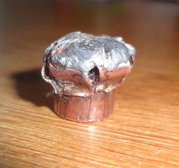

I found it to be a great deer-stopper. Eventually I settled on the 210 gr. XTP bullet over a healthy dose of H110. Running between 1400/1450 fps, I found that sighted to hit just a half inch high or so at 50 yards was really close to dead on at 100 yards. Keeping my shots inside 100 yards I never lost a deer. Over the years I shot coyotes, Whitetail Deer, hogs and Elk with the 210 gr. XTP load. It just works for me. Personal confidence goes a long was toward something working well.

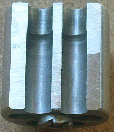

At one point in the life of this sixgun, I was shooting some factory “Seconds” that I had gotten. Firing them from the Bowen Ruger, after a couple cylinders full, I suddenly had one cartridge that I could not get out of the chamber. I had to remove the cylinder from the gun and drive the cartridge out with a brass rod and a small hammer. Looking at the cartridge I could see a long “scratch” or mark on it and I suddenly got a sick feeling. Shining a light into the chamber of the cylinder I discovered one chamber was bulged into the bolt stop notch! Now the .41 cylinder has a wall thickness quite bit more than the .44 Magnum. But the thinnest part of the chamber is the bolt notch. And one of the factory cartridges that I had fired had bulged that bolt notch.
I sent the gun to Gary Reeder and had him make a new cylinder for it. Gary did excellent work and when I got the gun back I ran it through tests for quite a bit and found that it was as accurate as it had ever been! While Gary had the gun in his shop I asked him to replace the factory trigger with his “Set-Back” trigger. His modification kept the trigger back at the rear of the trigger guard where they are supposed to be. I really do not like the Ruger New Model trigger that moves so far backwards and forwards. In heavy recoiling sixguns the trigger coming forward will bite the trigger finger and often take off some flesh when doing so. Especially if the gun is a heavy caliber like the .475 or .500 Linebaugh. The “Set-Back” trigger solves all that. Plus it looks better and to me, feels better!

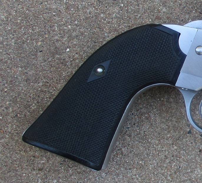

The finishing touch on the gun was a set of grips by Paul Persinger of El Paso, Texas. The grips are made of Ebony and are hand-checkered 32 lines to the inch. They really set off the stainless look, and they are comfortable to shoot. Paul makes some of the best grips and I have more than a few of them on various guns.

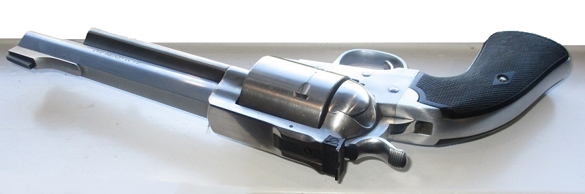

The bulged cylinder

Hand-checkered Ebony grips by Persinger
