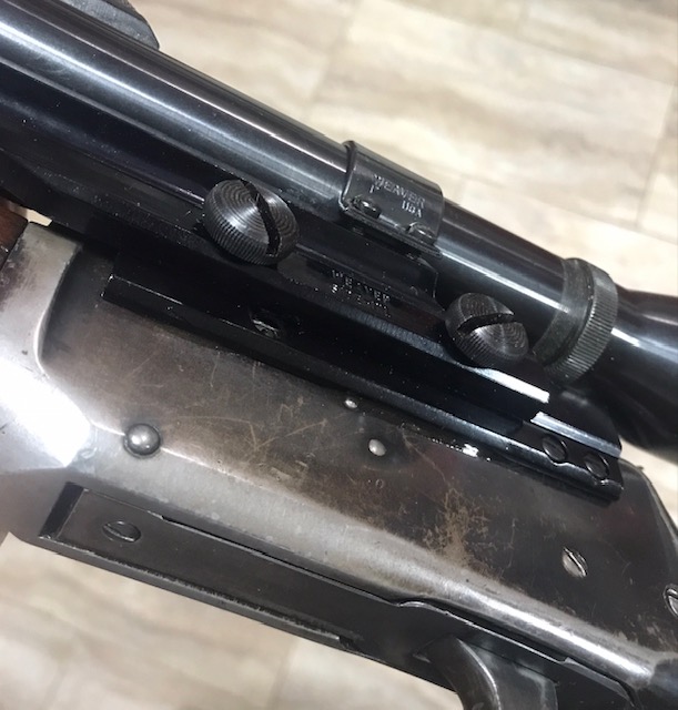

I can't mount the forward base screw because of the difference in threads on pre-64 vs post-64 M94's. The earlier guns use the obsolete #11-32 threads on the "finger lever pin retention screw" and later guns use the today common 12-32. I cannot find any thread die new or old for 11-32 with a O.D. of 0.197". A common 10-32 is 0.0190". I might try a 10-32 bolt then get a die to re-thread the #11 to a #10 if only 0.003" on each side of the OD is the difference. Only three or four threads hold it anyway. Maybe just maybe it's enough to hold a little.
In the meantime I cleaned the receiver with alcohol and "glued" the base on with 5-min. epoxy and used the rearward two mounting screws. I've done stuff like this before and it worked. It might this time too. I left it untrimmed so you could see the epoxy if I showed it. The stuff comes off pretty easy if you need it to. It is such a crazy thing to mount the scope off to the side like that anyway. The old K4 Weaver might not have enough adjustment to sight it in. I want to tinker and see what I can get done with cast bullets. I'm motivated by Jim whacking gongs in front of witnesses at 1100 yds. with his iron sighted pocket .30-30. I'm just after good 100 yd. groups.

The Weaver #3C base is for a late production post-64 rifle. It has this special screw to replace the forward mounting screw which is a #12-32 and has an OD of 0.219". I might be able to re-thread it for the available 10-32 (0.190") and IT fit in the 0.197" hole. But I'm not holding my breath. It might not fit, might not be needed (my trick work), or the old scope run out of clicks, and can the whole project. I know where some old Williams sights are! LOL

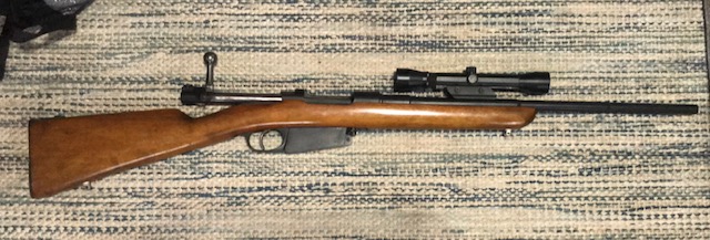

We did make one on an Argentine 1891 Mauser re-barreled to 7x57. My friend still has it. A left over TC Lobo 3X scope topped it off. We bobbed the barrel to around 16-17". Even with the straight bolt handle it is a peach. Anyone can shoot it and it drills nice 7mm holes!

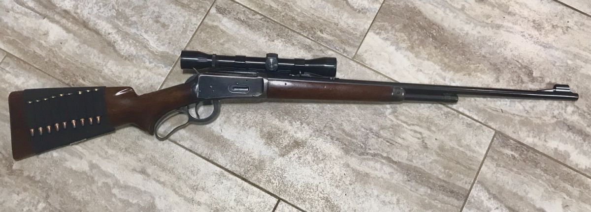

I'm re-creating a long lost fetish of a young boy. It had to be a side mount and a real 1894. They make a "short" side ring-mount and a long one. You have to use a long one on the 94. The short one is for bolt actions. If you find one today it's likely 40-50 yrs. old.
