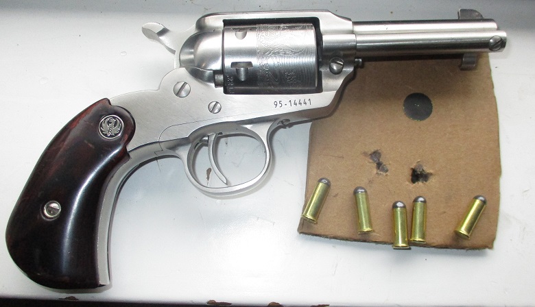

I loaded 5 more Long Rifles and set a target at 15 feet. Some of the blame for the 2 shots to the left can be attributed to the shooter.

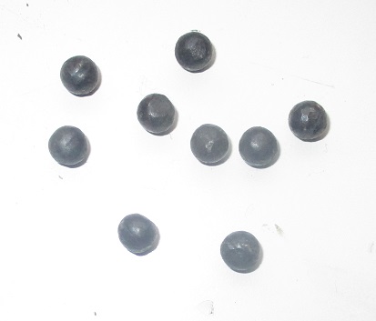

Recovered balls. Some engraved the rifling deeper than others.
