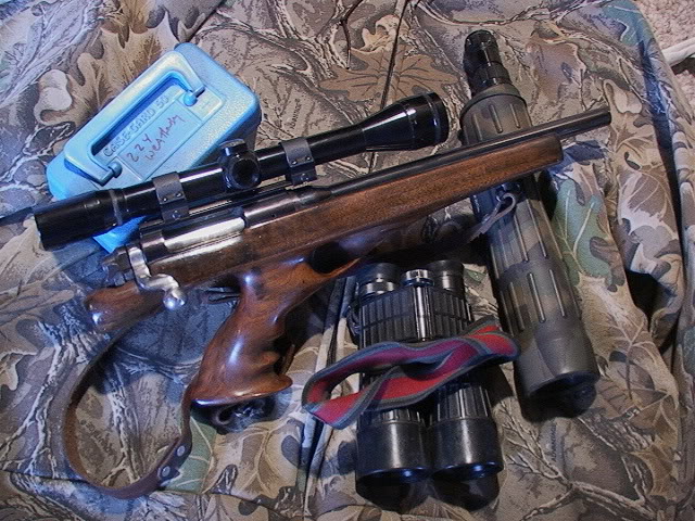

Having a 222 or 223 in a 10 inch TC barrel is OK as long as you realize the power loss. One of my favorite hunting handguns was a custom XP-100 I built in 224 Weatherby. I don't know how much power or speed loss I had but it was extremely accurate and killed a lot of ground hogs so I didn't worry about the power loss.
