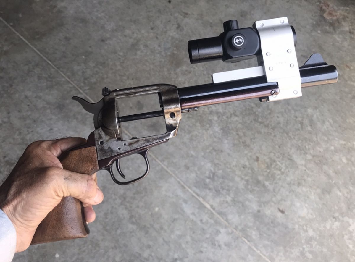

I work with a young man who is interested in the new AR deer seasons and trying his hand at handgunning! He bought the revolver years ago, A Virginian Dragoon made in the USA around 1976. It’s a .44 magnum, he has never shot it. In fact he didn’t realize it didn’t have a rear sight blade missing! I gave him a Ruger white outline blade and installed it.

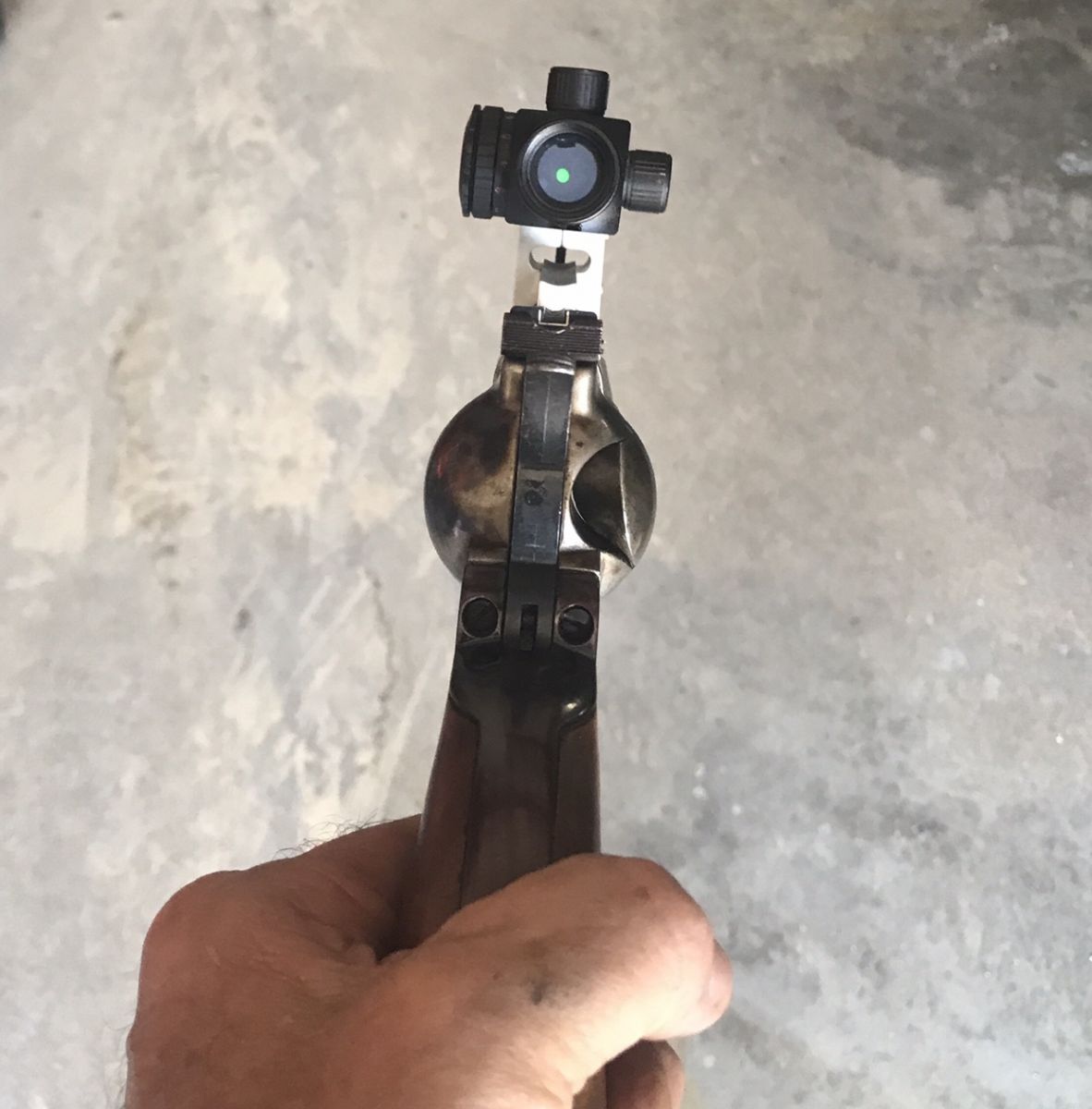

Years ago I bought this B-Square mono-mount off EBay for like $7. I used it on an old bolt action .22 single shot for a while. It was made for a 10-1/2” Virginian. This gun is closer to 8”. I flipped the sight around and notched it to clear the ejector housing. A cheap China red/green dot stuck on to see if it has a faint chance. It’s fun anyway. We’ll start with some good .44 Specials.

The design of that clamping mount
Friday, July 12, 2024, 07:06 (841 days ago) @ WB
As mentioned this mount is one for the 10-1/2" barrel model applied to a 8" gun. The piece laying atop the barrel is actually spun around backward in this application. That piece is supposed to position at the back of the front sight ramp to assist the clamp from climbing forward under recoil. Not being able to use it here, I applied it to stiffen the mounting horizontally. There is a groove atop the piece for see-through sighting too. I hand notched a slot to allow the front of the clamp to just touch the base of the front ramp, duplicating the original design intent.
The whole rig looks a bit suspect but I have used B-Square mounts before on odd things like military bolt rifles, M1-A, Mini-14, and 1911. While they look like odd designs they are always well thought out and work well. But this one is modified AND a .44 Magnum. I think we will try it with lighter loads, it does not take much to kill a 100 lb. Whitetail. Some 200 gr. JHP at about 1200 fps sounds like the optimal medicine for this new shooter. This china red dot is much lighter than a proper scope optic too. If it will just hold together and not sling the battery out!

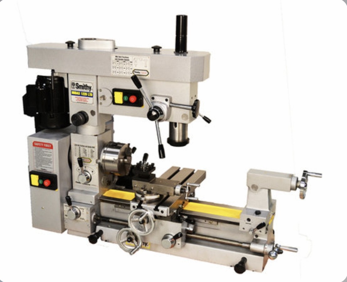

I do not want to trigger any questionable behavior. It has worked ok. I actually have a Smithy 1220 3-in-1 Mill, lathe, drill press, I keep here. They get to use it and I play on occasion. The arrangement works out. It's more than enough for what I do.
