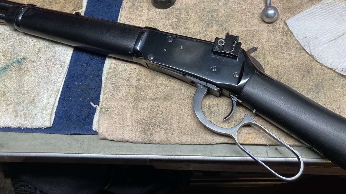

When the packaged arrived it was easy to see this was a rifle of some sort. Unpacking it I found a Winchester 30-30 Trapper of early 1980’s vintage. Inspection revealed the barrel band was blown apart but other than that the gun appeared in fine shape. Working the action it felt gritty like it was full of sand. Looking down through the top of the action did not reveal any dirt so I put that off for future inspection.
It turns out my friend had bought the gun used. The finish was worn pretty badly so he took it to a gunsmith in his area for a reblue. When he got it back the gun not function properly. The action was stiff and gritty. He shot it some but was real frustrated with it. During one of his shooting sessions the forward barrel band came loose, swung in front of the bore and not noticing it, the next shot he fired blew it apart. By this time he was really frustrated with the gun and decided to get rid of it. He did not feel right about selling it and knowing I liked to tinker with guns he decided to make a present of it to me!
OK! Thank you!
I started looking around for a barrel band and found a friend in Colorado who had a bunch of them. He was kind enough to send me what I needed. While waiting on the barrel band I stripped the gun to see if I could figure out what the grittiness came from. Imagine my surprise at finding the gun full of bluing salts residue! There was residue on the loading gate, on the frame rails, around the screw heads and in the spring detents. Whoever had blued the gun did not do a clean-up job on it.
I sprayed the insides with gun cleaner, scrubbed it with a small toothbrush and then wiped it out as clean as possible. While I had the gun apart I polished the underside of the bolt, hammer and the hammer face. I also lightened the spring detent in the lever assembly and polished a few places on the lever where parts moved against each other. I then lightly oiled the parts, wiped them clean as possible and reassembled the little gun.
While waiting on the barrel band I went online to Brownell’s website and ordered a Williams 5D aperture sight. I like “peep” sights on my leverguns. This would not be a gun for target use so I did not need the fine adjustment of a sight such as the Fool-Proof model. A “fixed” sight would work just fine. The 5D is adjustable and once adjusted to the load I will use I will lock it down and leave it. I also plan to use the sight as a "ghost ring".
When the barrel band came in I installed on the gun, then walked down to my range to give it a try. Shooting the little rifle was a pleasure, but it seemed “balky” when levering. It did not feed smoothly like my Model 94 Carbine and would often require working the lever 2 or 3 times to get a shell to feed. Sometimes the cartridge would start up, hang up and then the subsequent working of the lever would pop the cartridge out of the gun. At other times it would feed into the chamber.
Back in the shop it took some time to diagnose the problem but eventually I figured out that it was a carrier timing problem. I stripped the gun and re-cut the carrier (lifter) and that was that! Now it fed flawlessly as fast as you could lever it. The Williams sight had arrived and I took the time to install it. Then it was back to the range to get it sighted in. That was fairly painless and in no time the Trapper was ready for duty.

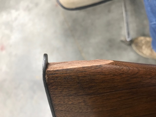

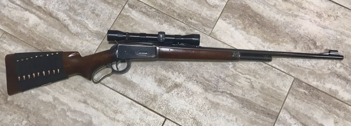

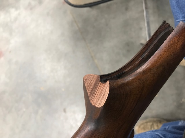

I went the other direction 180 degrees, as is my norm. It has to be interesting to me. Doug had this M64 that the UPS busted all up. Actually it was lots worse than the pictures. I finally fixed it using old gunsmithing techniques with modern Brownell's Accraglass. It's uber sound for that rare buttstock. Rather than selling it with a discount and story about the repairs I just bought Doug out. I like to keep a .30-30 around and traded my post-64 M94 off to garner some funds toward this pre-64 (made right at the war time when production was in limbo several years).
I decided to go optics using antique new-old-stock sourced parts. I even mounted a vintage Weaver K4. However the larger 3rd. mounting screw on the pre-64's is an obsolete thread pitch and size. I mean it's a crazy #11, not 10/12. I've tested them not to be compatible. I could drill out and re-thread to modern but I've held off so far. But in lieu I epoxied the mount to the receiver with the removable 5 min stuff and used the two screws that did fit. I've not tested it yet but soon. If Jim's accuracy is a benchmark surely I can get close with optics and powder coated cast bullets. We'll see.

Period accessories. That's why I just couldn't re-thread that one screw. No sling swivels etc. Makes collectors go nuts. Boy the stock was screwed, pistol grip busted off, and even steel buttplate bent with toe broken off. The buttstock looks pretty good now, certainly functional.
