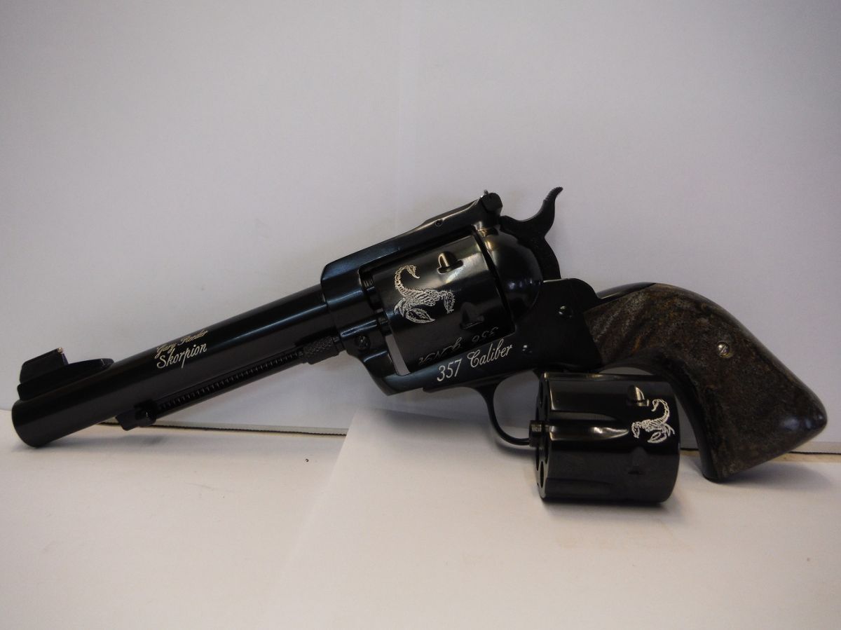

I'm not a good gauge but this is mine...
Monday, September 09, 2024, 09:49 (781 days ago) @ Pacecars
Not many have both Sasquatch AND Nessie (other side) engraved on their custom guns! My gun was a convertible so the extra cylinders. A bit silly expense since I seldom use the extra cylinders but I HAVE them if I want them. I can shoot lots of different rounds! It's drilled and tapped for scope as well.

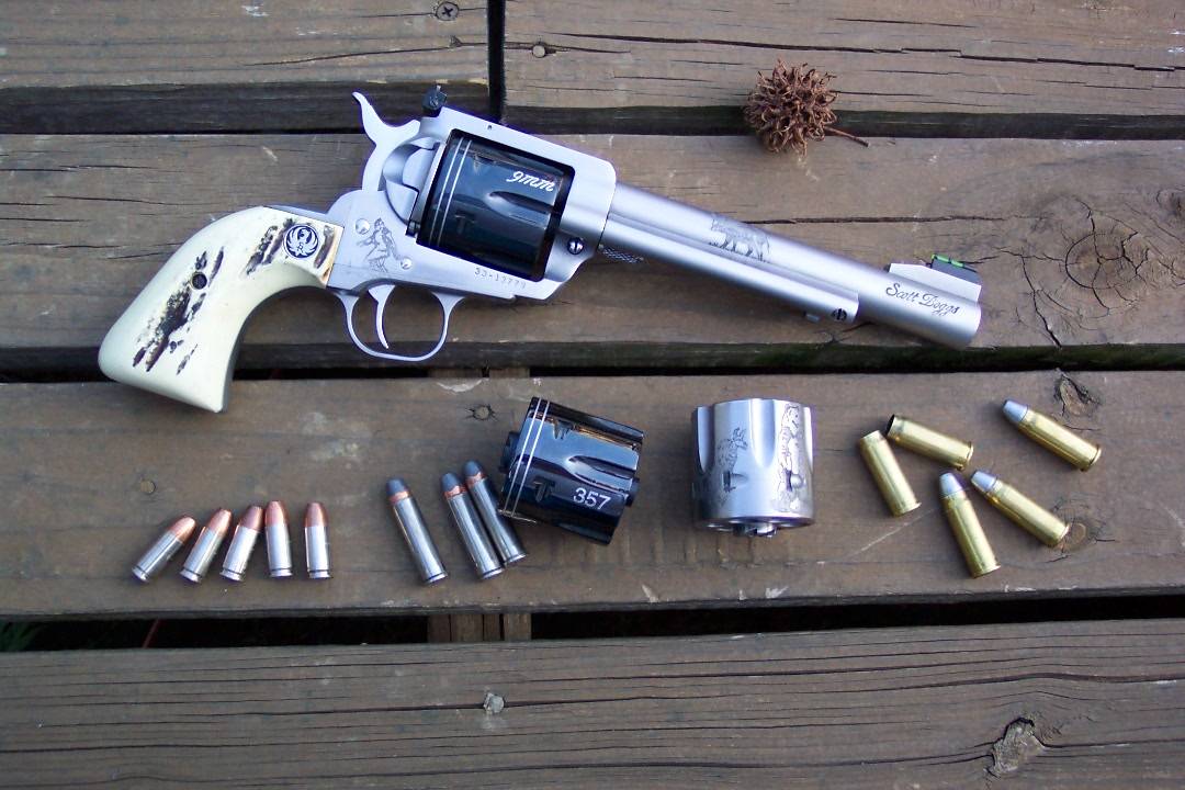

And mine!

Tuesday, September 10, 2024, 04:15 (781 days ago) @ WB
Smart move
Monday, September 09, 2024, 16:13 (781 days ago) @ Pacecars
![[image]](images/uploaded/2024091011144966e02a292a6d2.jpg)
