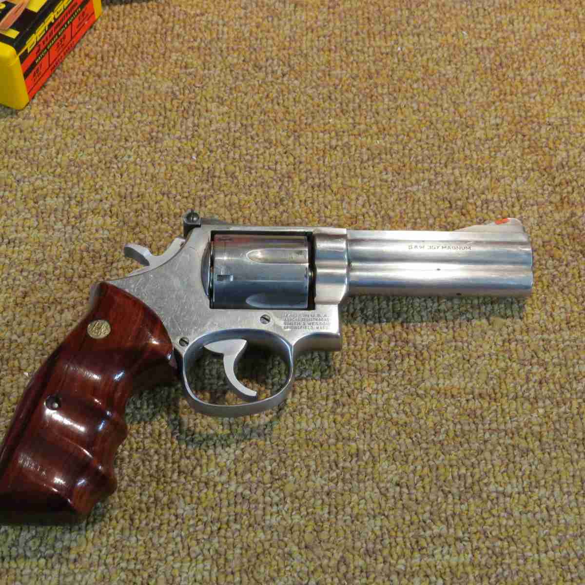

that one handgun idea means, to me, it primary protection, and standing in on everything else within reason. I love my old Remington Rand 1911 with later GI hard slide, and love my 4 5/8ths 1976 Blackhawk .45 convertible.
But, what I have settled on for that all-around handgun is one I see as a modern Medium 38/44 Heavy Duty, the fixed sight L-frame 681. With 158gr JSP/JHP doing realistic 1200-1300fps from the 4", it would work against a black bear or hog as for woods, finish a roadside crippled deer, and against bad guys and cover would also work decently. Slick draw, smooth/light DA/SA, low maint. stainless. About same weight loaded as the RR or BH, but faster on follow-ups and trimmer than the BH with slicker draw. The RR a finest gunfighter, but lacking in other uses.
Anyhow, sorry for butting in, but when I read that post about one-handgun, had to register just to throw this one out which seldom is recalled, it made only from 1981-1992.

No bragging groups, but these guns shoot. Just yesterday was at range and dredged one of those skinny little Red Bull energy drink cans from trash and put it on the 50yd berm and hit it 5 for 6 with the one miss 2" off at 10 o'clock. If you see a decent one, I advise you grab it.

I am aware of your proficiency with a single-action, and in my comment as to faster follow-up shots over the BH, nearly added, "unless you are Jim Taylor". Glad you saw this, as I expected you'd get a kick out of the low fixed sights which still are quite good. These seem to be regulated for full house 158s by my experience and others I know from the highway patrol.

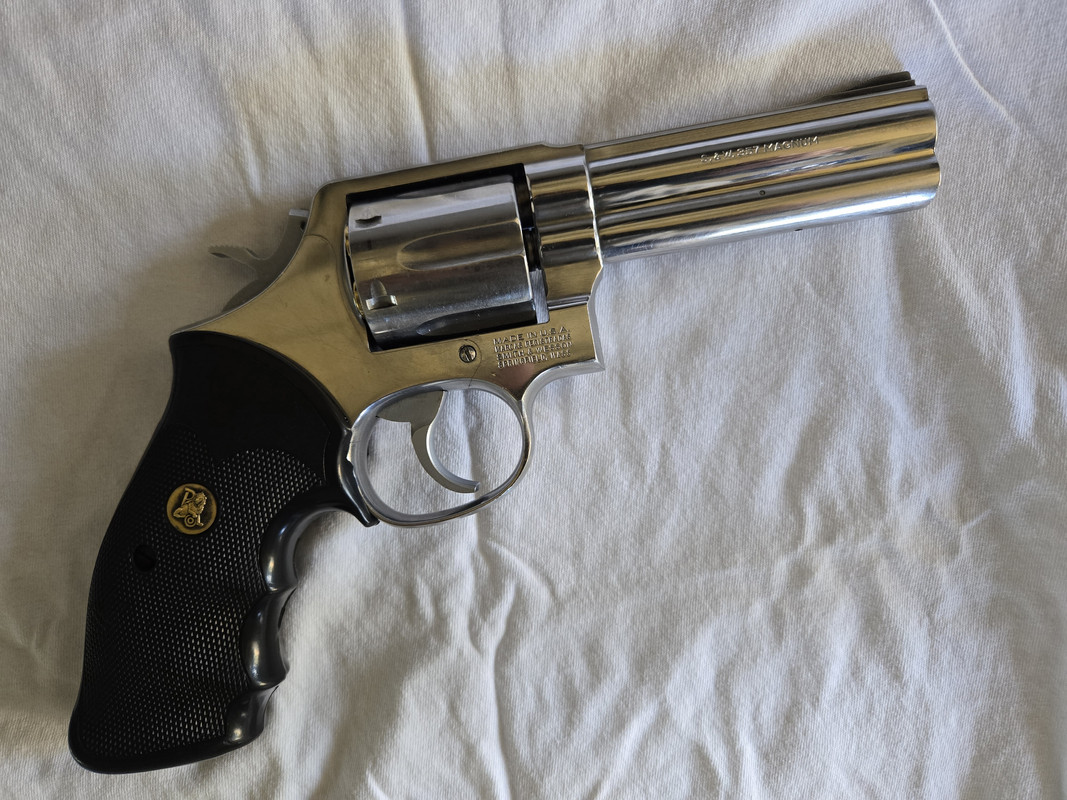

The 681 was the last hurrah revolver here for
Jerry Kiln
Friday, October 04, 2024, 05:39 (756 days ago) @ jthomson
highway patrol. There were others. New York State Police, maybe Michigan State Police, and a couple more, as well as corrections, Customs and Border Patrol. Budget maybe played into the 681 vs 686 but I never cut my elbow on a fixed sight revolver. Last hurrah for all, as Mister Glock came bearing gifts of nearly free guns and generous trade allowances to corner LEO market and bragging rights for sales.
I have a 4” 686 plus. Love it, and a 66 4”.

highway patrol on which was the best issue revolver, the 4" 681 or 4" 66. The 66 certainly an easier carry, but not by all that much. Both are fine shooters, the 681 just more durable.

My no-dash/no-M-stamp(recall compliance) 681 works fine with in-spec ammo of either weight, and follow advice given since the magnum first came out, and test ammo for primer flow before carrying. I don't care for the wicked 125s as too limited to anti-personnel use, accelerated wear to throat/cone, and just plain wicked to shoot.
