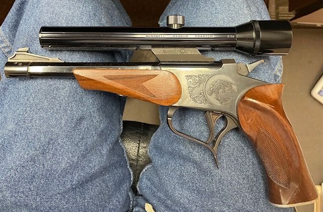

My build up 1974 TC Contender hunting gun. Originally a .357 Magnum it's been rechambered to .357 Maximum. I still have the "hot-shot" choke and wrench as well for playing with shotgun antics. The rig is fitted with a period 2.5x Bushnell Magnum Phantom rail scope. 0.5 MOA clicks but it always worked fine back in the day. Having a proper designed throat (thanks to a good Maximum reamer) it fires .38/.357 Mag. just fine and is accurate as well. The 8-3/4" braked barrel punts out my 180 gr. cast bullets at 1650 fps. Recoil is lively but it is a small gun, about the same size and weight as a 6" mid frame revolver, about 3 lbs. The way they used to be. Today only GNR's Pirate Guns on the G2 get close. Gary's G2 framed 9" .41 GNR is an amazing game gun! I've witnessed one shot kills on 2,000 lb. plus critters. I too have a .41 GNR barrel that probably would even work with this frame. Hunting handguns are sooooo big these days. Basically the same weight as modern light carbines. But it's been a fun game over the years and there is room for all.

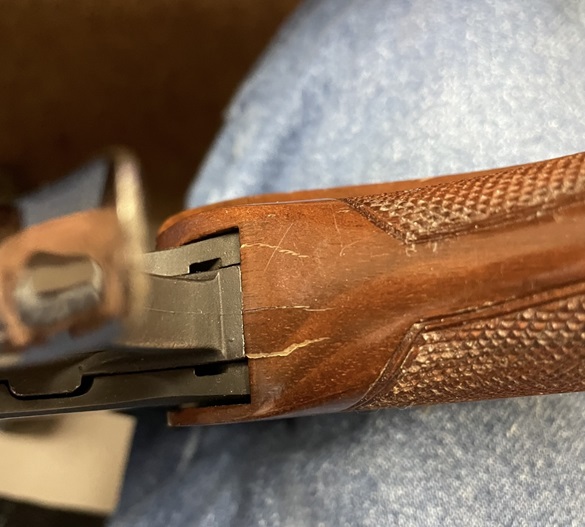

But I had some issues. I did some lug swapping to get the barrels to lock properly. Then I found I had broken the vintage grips with the "hard open" frame as the trigger guard did not properly clear completely. It also likely interrupted the re-cocking some. I'll have to relieve the wood, drill some small holes, and hydraulically inject some Accra-glass into the cracks using hardwood pins, then refinish. It's been a fun build, and is completely serviceable, even legal during special "straight wall" cartridge hunting seasons.
