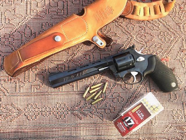

I’ve had several Taurus Tracker revolvers. 8” run 2200fps, the 6” does 2100. I get 1”-2” groups at 50 yds. Still have an iron sighted 6”. They are about like a k-frame chassis and 7-shot.
Found a pic of my Taurus
Saturday, January 18, 2025, 21:53 (649 days ago) @ WB
I stand corrected on the velocity. The 8” was 200 fps faster than the 6-1/2”. That’s what this one is I believe.
