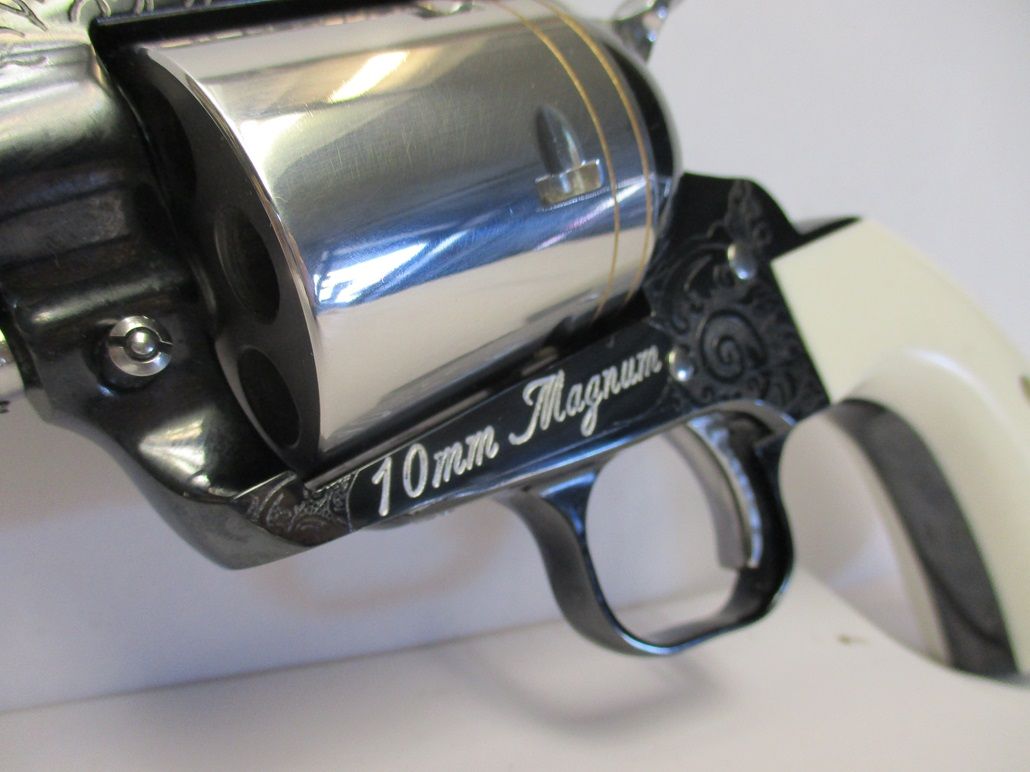

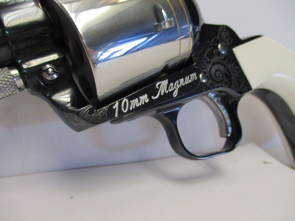

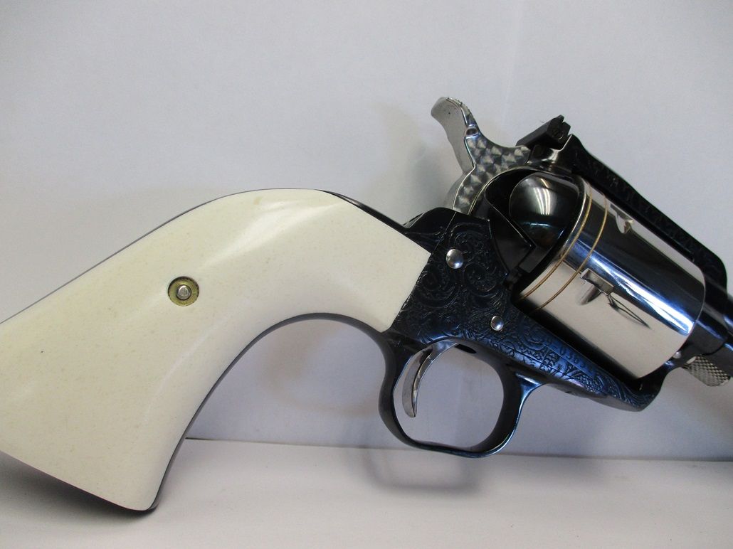

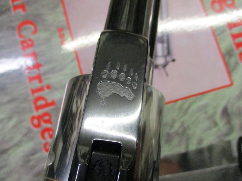

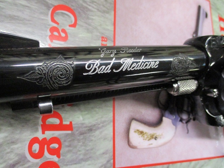

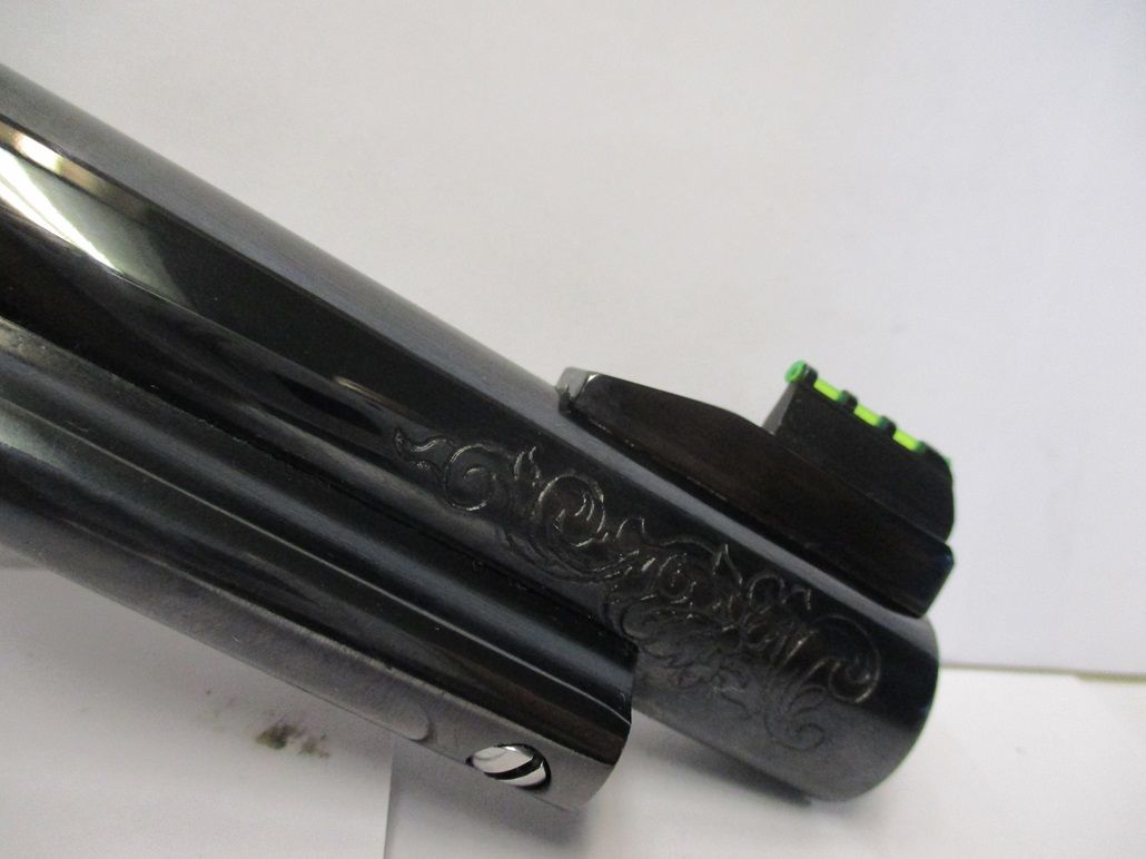

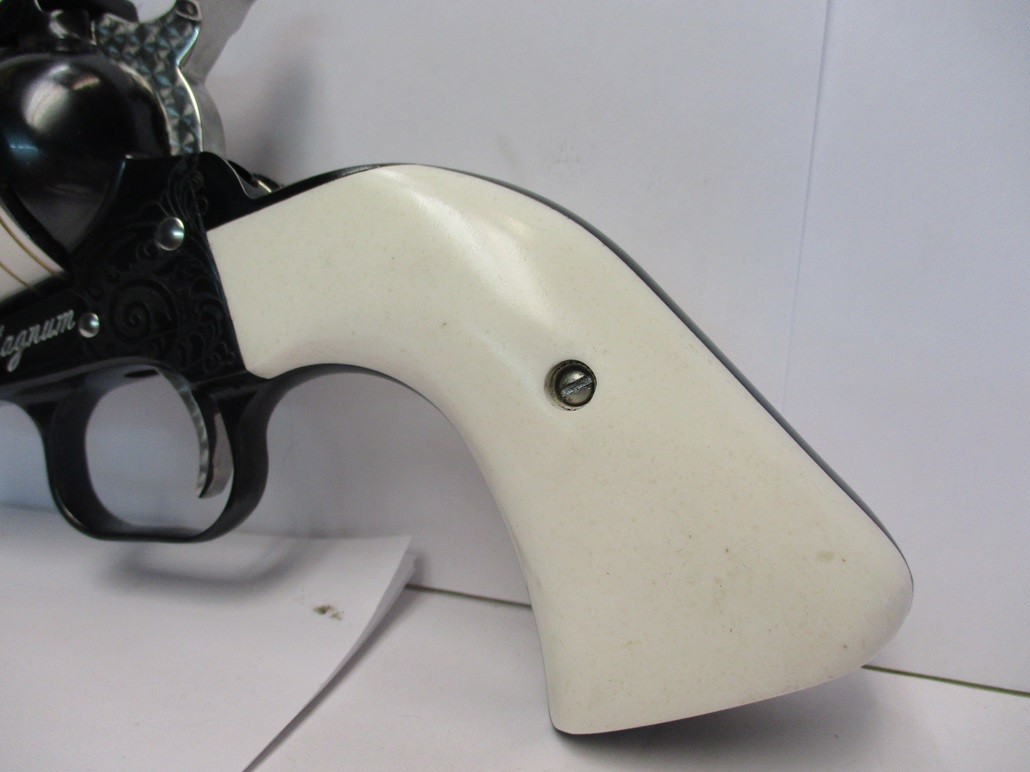

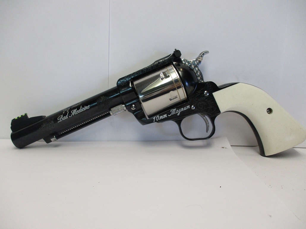

A new Bad Medicine just finished. This
Monday, February 24, 2025, 16:15 (612 days ago)
beauty is chambered in 10mm Magnum and has a 6½" barrel. The gun is a two toned gun with our deluxe Black Chromex finish and a beefy unfluted stainless cylinder. The gun has a Belt Mountain base pin for added strength, a set back trigger for the utmost in accuracy, a jeweled hammer and trigger, the interchangeable blade front sight with the green fiber optic blade, and our Magnum gripframe with ivory Corian grips. It has had our Positive Performance Package and is smooth as silk. All in all a really nice revolver and accurate too. This gun should normally run a bit north of $2600 but I have it specially priced at $1995.

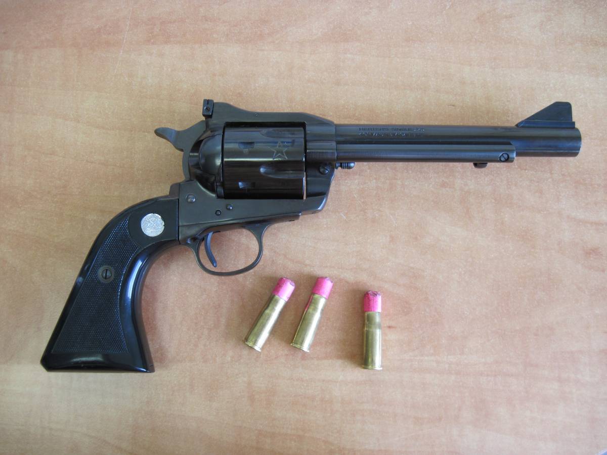

Pic is my Reeder Cylinder'd .401 Supermag (a dead caliber) rechambered to .38-40. I do have two cylinders. The pink .38-40s are experimental historical replica shotshells.
