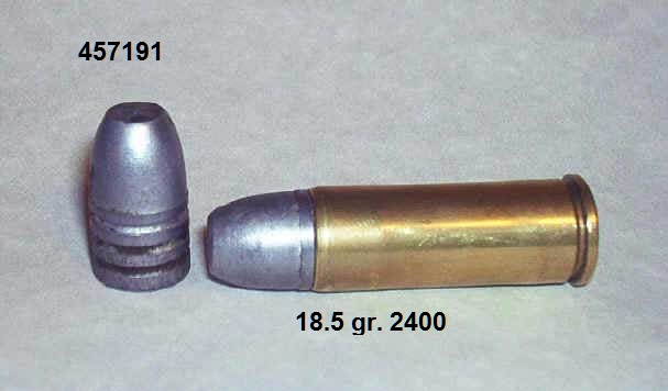

I did the "down-sizing" thing with the 300 gr. .45-90 bullet in the early days of experimenting with heavy .45 Colt loads. I sized it from .458" to .456" to .452" and used it in my Ruger Blackhawk. I sized some all the way down to .450" later on but that pretty well wiped out the lube grooves.
![[image]](images/uploaded/2025022716210367c090efdeb9f.jpg)
Sizing down cast bullets .410 to . 401

- Yeah I've been re-sizing 300 gr. .458 JHP for .45/70 - WB, 2025-02-27, 13:24
