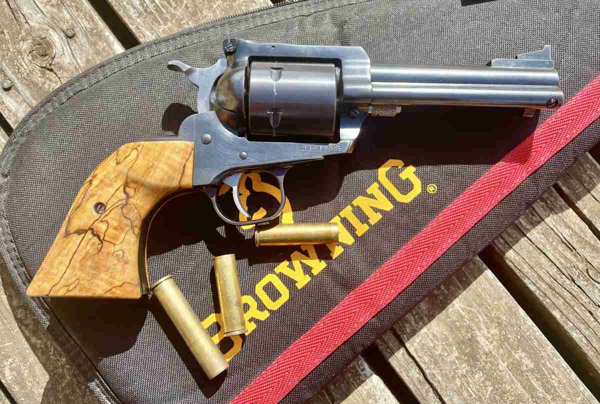

Even a change of grips in tribute. They were almost white, unfigured Holly. Grips by “Bear Paw”.

Bro. Taylor will appreciate the .44 cylinder now bored straight through at 0.480”. A 3.5-4” “Taylor Throat” looking span then some .44 caliber rifling! There are ample directions for proven success. Now the process of wonderment, measuring, experimenting, recording.
