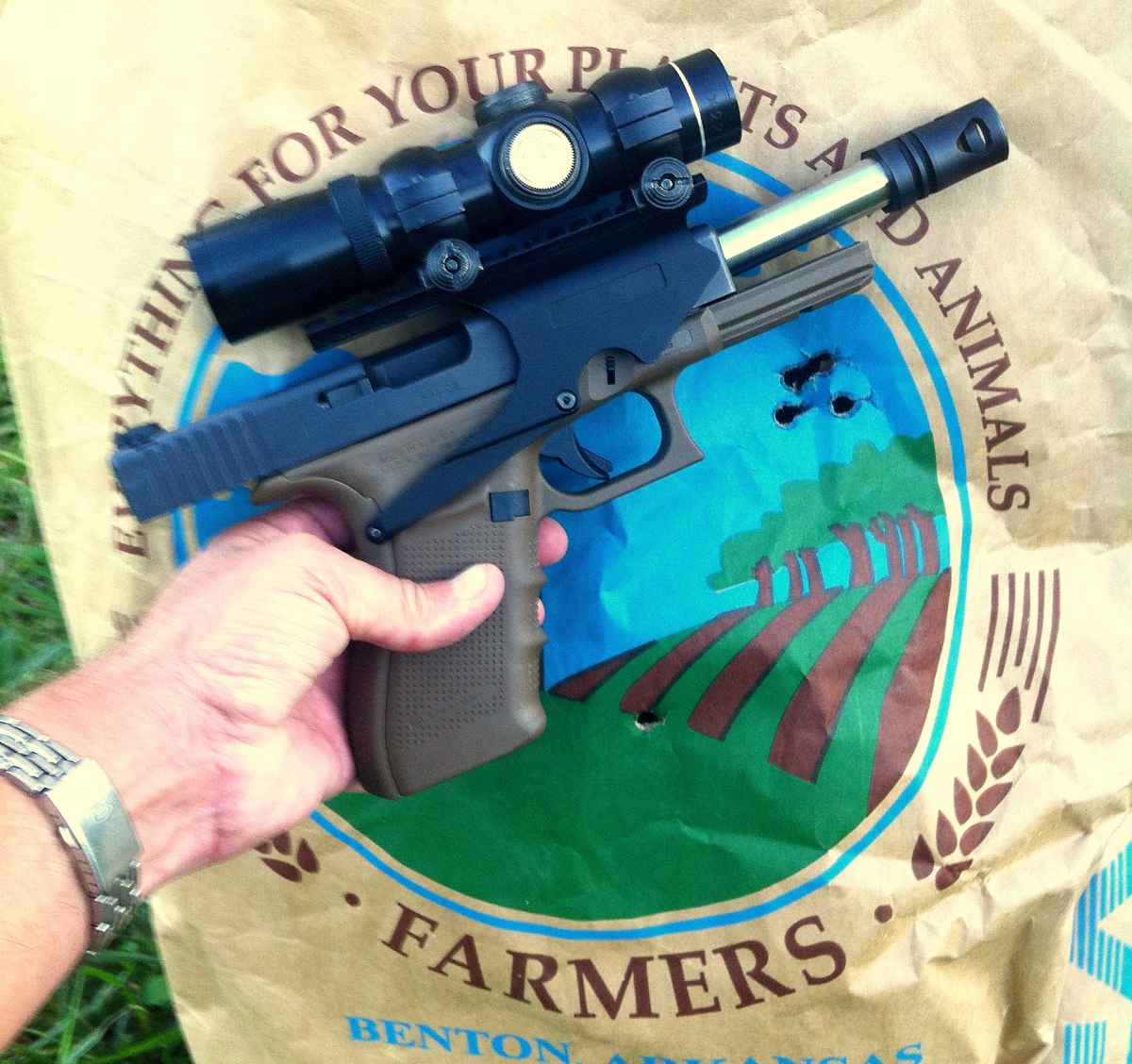

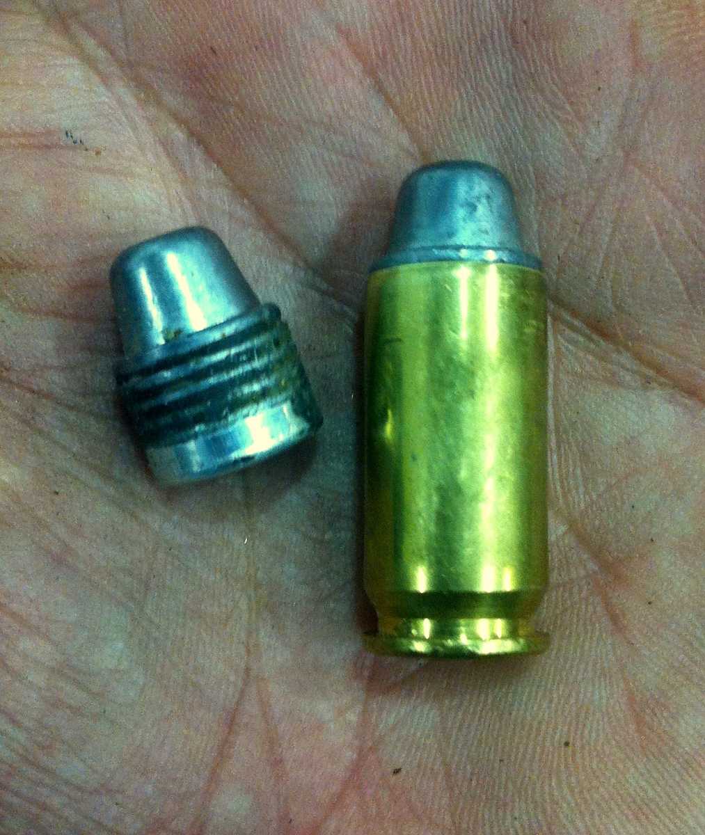

With an auto loader there are many things to consider. The chamber has to support the case web. It also has to stay locked until pressures are down. We “built” a Glock 21 with custom chamber on a conventional rifled barrel. Besides re-chambering the chamber throat was modified with a 1/2” freebore. Much like Weatherby rifles. The bullet travels forward to about .45 Schofield length before rifling is engaged and pressures are truly realized. That’s a big deal. Downstream I also went from a 17-18# recoil spring to a 26# heavy duty. Lastly on the end of the threaded barrel I used a special “chamber” muzzle brake to slow slide opening and jarring recoil effects. My friend (using a 1911 platform) decided on the same mods except he used a special three spring, special calibrated, captured recoil spring system. His 200 gr. Jacketed bullets reached 1400 fps. I was using special gas checked cast bullets to achieve the same. I did shoot 250’s and even 300 gr. at 1200 fps. But I’d not want to do it too much. All wear is greatly advanced with the heightened performance. I was able to duplicate the same level of performance with a 6” custom barreled Glock 20 in 10mm using custom cast loads in conventional rifling as well. Up to 230 gr. anyway.
In short. It’s a good way to blow your nose off. Even with a well designed “factory” kit. Some designs can let the sear go without being fully in battery. I chose the Glock as it has a whole munch less parts than the 1911. No link, pin, bushing, etc. The .45 Super loads with a little forethought would be a better place to start, IMO. Or just go straight to 10mm. BTW, semi-autos need semi-auto shaped bullets to perform best, I’ve found.
