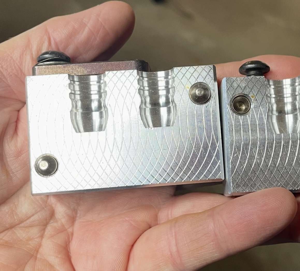

Special dies to assist with deep seating and crimping, wad cutting tools for over powder and shot, special bullet molds.
No lube in grooves as that is reserved for lead displacement while the .45 slug is hammered through 1-1/2” of .430 rifling! A lot of spin induced real fast after 3” or so of .45 smooth bore. The supplied mold says 295 grs. Target performance was 1200-1250 fps. They did say accuracy was easy to get subsonic.
Multiple projectiles loads are said to work too. A 450 gr. payload would need to be kept on the lighter side. (Like I mentioned you’d need to remove lead from grooves and use a felt under wad) But what a hammer!

I wonder about powder coating since they
Saturday, March 29, 2025, 19:44 (579 days ago) @ Jim Taylor
Mandate no conventional lube. Seyfried claimed the lube would not compress and made so there was no place for the lead to displace. It needs somewhere to go. Like these new all metal bullets they cut grooves into. It’s not for lube but a place for the metal to flow into displaced by rifling. It really lowers pressure with those types of bullets.
