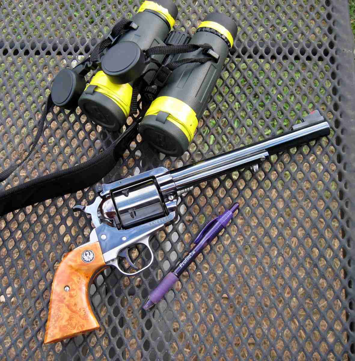

My favorite .44 Mag. Sorry S&W, love you too, but the SBH is where it all started with me. This one has custom regular BH grip frame on it. Fits my girly hands better!
