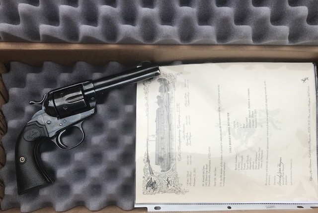

My 122 yr. old .32-20, still a dandy today. (demands .311" bullets or bigger)
![[image]](images/uploaded/2025052721332468362fa4a3412.jpg)
