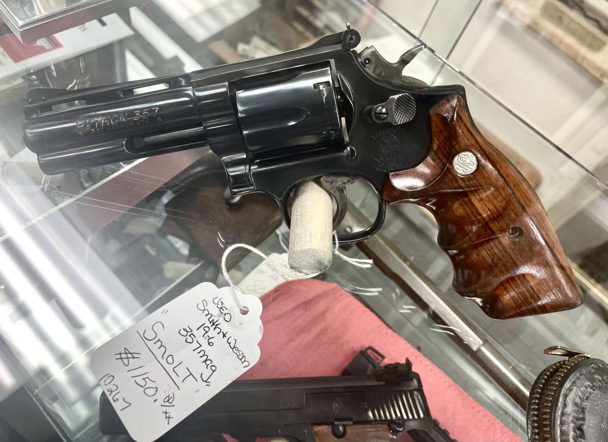

LGS has a really nice “Smolt” on a M19 chassis
Thursday, July 24, 2025, 16:19 (461 days ago)
It’s a blue 4”. Stock looking Colt barrel and front sight. Ball crane lock, solid and tight timing with minimal cylinder gap and wobble. Really crisp. Even fancy 1980’s S&W factory finger groove combat stocks. Crap! Not sure who did the work but it’s a quality job.
Sure nothing I NEED! It could benefit from a top end blue job, but don’t look bad either. Would take a solid grand to take it home. I knew I should not have gone in there.

Here’s a pic. Gary as had a few over the years.
Friday, July 25, 2025, 11:24 (461 days ago) @ drdougrx
You lose the front locking detent on the ejector rod going to a Python barrel. The common solution (Brownells sells a kit) is to drill and install a spring ball and recess in the crane arm and frame. That, in itself, demands notable skill. Then the barrel threads are different.
