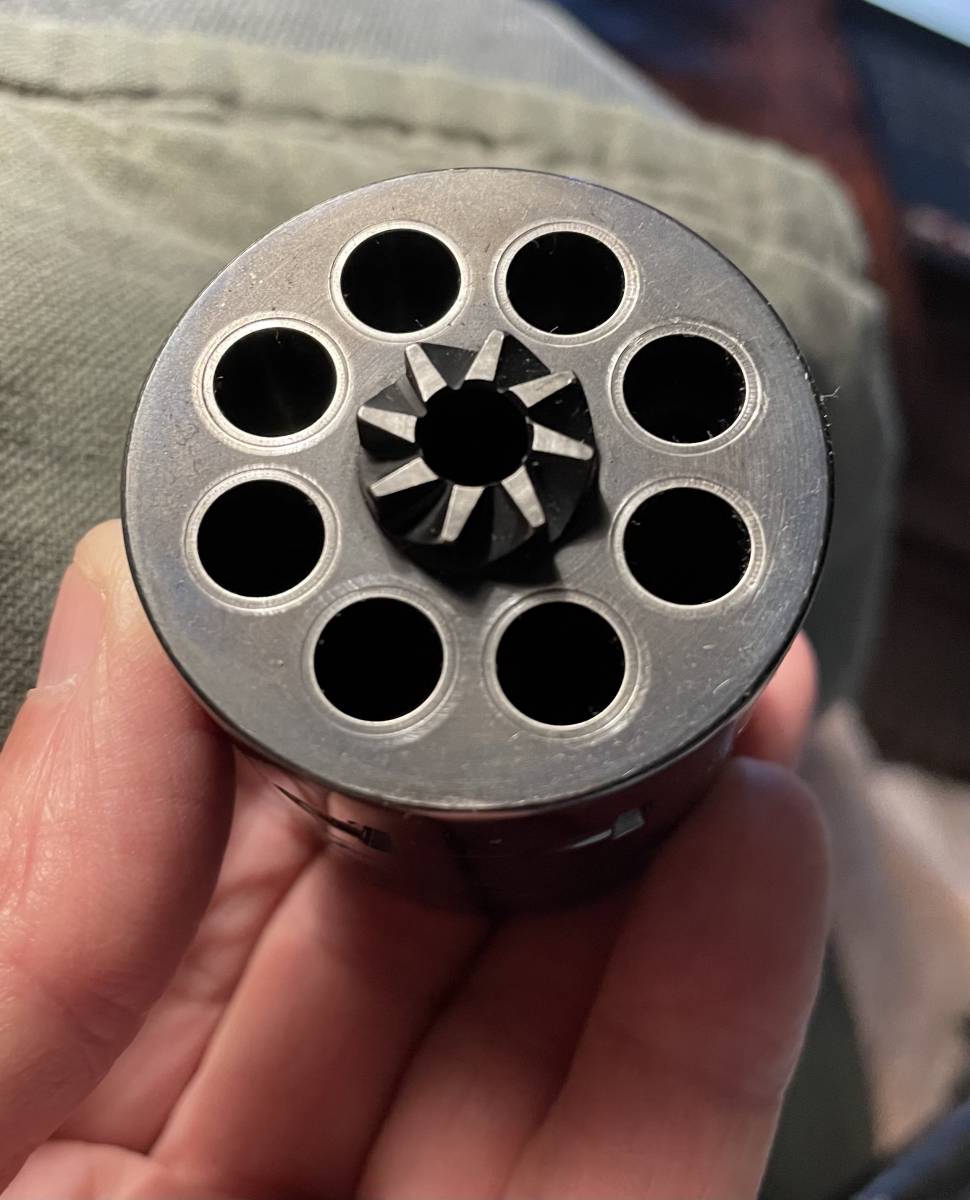

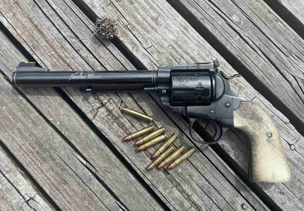

This was a cool build, .255 Banshee Javelina
Tuesday, September 16, 2025, 08:55 (408 days ago)
It started as a .44 Mag. Bisley. We had some lightening cuts to the frame done in (4) places, perhaps an ounce relief per spot. Thank goodness. When anyone picks it up they always exclaim at the heft. I didn’t consider it’s basically a solid chunk of steel with tiny .257” holes bored. It weighs 57 ounces unloaded. A bit heavy on the hip it is perfect in the shoulder rig. The 75-80 gr. bullets easily scoot at 1600-1700+ with longer brass life. The Hornet case will loosen primer pockets early if pushed too hard. The heft certainly makes it a dream to shoot with weight dampening the wiggles. It basically has the trajectory of a .22 WMR rifle but twice the power. Old .25-20 lever gun performance.
Toying with bullets and the size of meplat manifests adjustable performance. That is a study in itself.

A solution to the loose primer pockets and flimsy brass on the 22 hornet would be using 327 fed mag instead. Much thicker brass, a little higher pressures, and much more case capacity, too. The brass is readily available from starline, unlike 22 hornet. It achieves all of this with a wider body, but because the rim diameters are similar, it doesn’t reduce cylinder capacity.
Of course, this would require a rechamber.
Gary has that in his .250 GNR, however
Wednesday, September 17, 2025, 20:53 (406 days ago) @ Keith
to keep some distance from the .224-32FA (Bob Baker's .22 on the .327 Federal), and Bob had distant plans for a .25 cal. version. Gary knew this, and did his on the .32 H&R case. Same idea as yours however.
On Bob's .224-32 FA you shortened the neck considerably. I didn't like trimming so I just used .32 H&R to make my FA rounds in one pass. Bob didn't think it was such a hot idea, but I got away with it.
I never did Gary's .250 as I was already invested in the .255.

If it’s based on a Blackhawk, it caN
Keith
Thursday, September 18, 2025, 12:19 (405 days ago) @ WB
The Blackhawk came from the factory chambered in 327 with an 8-shot cylinder.
That said, the ideal platform would be to start with the Ruger single sevens. Incredibly light and handy, even in the 7.5” barrel

The 250 GNR is excellent in the bearcat, where the 327 case would be too long. However, in essentially every other use case, the 327 just plain makes more sense.
