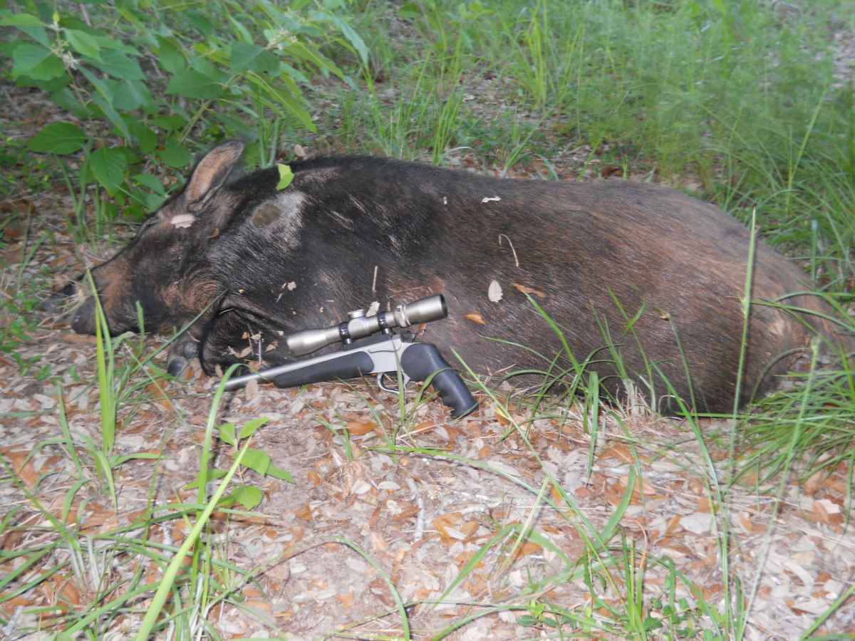

with the 30 GNR and 7 GNR both will shoot a 140-150gr bullet at 2400 fps out of a my 13" barrel G2.This hog was taken with the 7 GNR a few years back.
Sean
