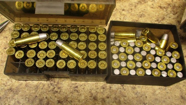

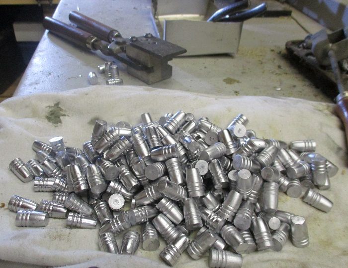

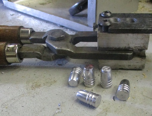

Since I was already casting and knew I was getting short on bullets for the .41 Magnum I dug out my old NEI mold and ran off a couple hundred. It's 230 grains .. flat point. I size them to .410" and they work well. I usually load 15.5 gr. 2400 but am working a bit lighter load using 8.0 gr. of Unique.

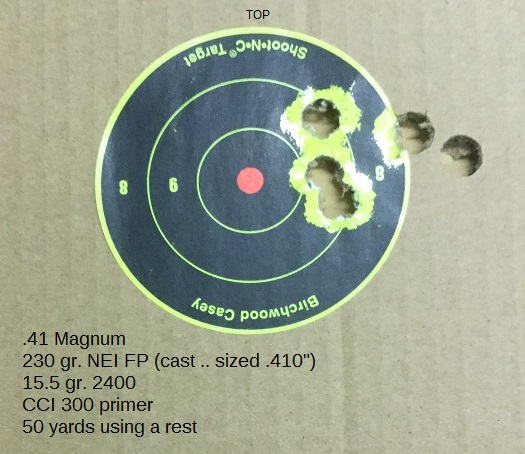

I shot these targets a couple years ago with this bullet and sixgun.

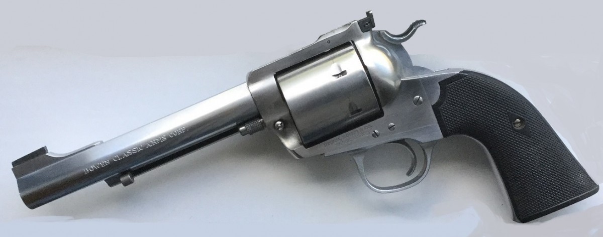

Good lookin gun and bullets

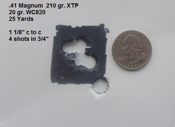

Mainly because I am old ... and I don't like getting beat up. And because I have used the 210 gr. XTP at around 1450 fps for so many years and shot so much stuff with it that I just don't want to use anything else.
My hunting load is the 210 gr. XTP and 20 gr. of WC820 (Military Surplus H110)
I was at the HHC with Gary and the crew in 2014 or 2015 .. I forget which ... shot a hog and a cow elk with that load. It worked just fine.
I've taken Mule Deer, Whitetail Deer, Javelina with it over the years and it has always worked well.
