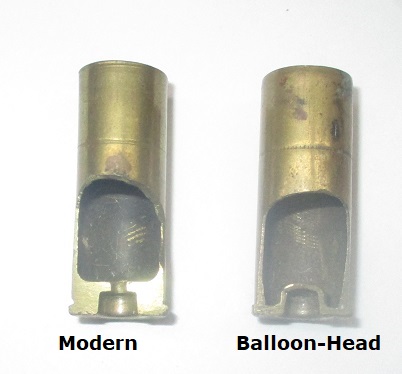

The .44 Special was originally loaded with 26 gr. of black powder while the .45 Colt was loaded with 40 grains black. The modern solid-head .45 Colt cases will not accept 40 gr. of black powder and still seat the bullet to the overall length of the original, 1.6 inches. The old cases had a lot more capacity.

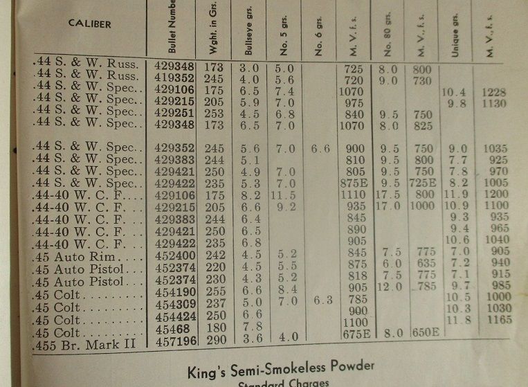

The original smokeless powder loads can be duplicated with Bullseye powder. The 34th edition of the Ideal Loading Handbook (1940) lists the charges with the then-available smokeless powders.

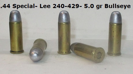

I have balloon-head cases for the .45 Colt but only 1 or 2 for the .44 Special. And they are old enough that I really don't want to shoot them. But simply reducing the powder charges slightly will get me where I want to go. I decided on 5.0 gr. of Bullseye for the .44 Special and 6.0 gr. of Bullseye for the .45 Colt. I may want to reduce that powder charge in the .44 Special by a half grain or so. I will know after I shoot some. I made the decision to go with 5.0 gr. after reading the Lyman 1950's and 1960's loading manuals. We will see.

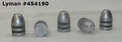

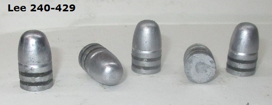

In the .45 Colt I am using Lyman #454190 which is their copy of the original Colt bullet. In the .44 Special I am using the Lee 240-429 bullet which is their copy of the original .44 Special bullet.
