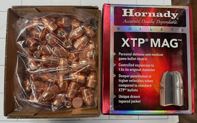

I got a buddy into handgun hunting and he is anticipating the arrival of his .45 Colt Contender barrel. We are working up a load to use for Whitetails at maybe 50 yds. I found at the LGS some 240 gr. XTP Hornadys. They make a 250 gr. as well. I think those are for heavier game and possibly the .460 S&W or .454 etc. I think the 240 may be a bit lighter jacket for expansion at lower velocities. I think maybe 1200 fps or so would be a good load, not to spook his horses too much. He's not much of a handgunner and we might take things for granted, much more than that is a handful for "normal" people, others besides Misfits. lol

Those are meant for higher pressure loads

Friday, November 07, 2025, 11:10 (355 days ago) @ WB
like 454 Casull and 460 S&W. The 250 gr XTP is meant for 45 Colt and does best around 900-1400 fps. The 240gr can handle over 2000 fps and has a stronger jacket to handle the much higher pressures. Out of a Contender you might be able to get it up to where it will expand reliably.
So I got it bass-ackwards! 240 XTP heavy jacket!

I can save them for my .454 then. Thanks guys! I wanted some expansion. I didn’t want him to lose one with a through and through cast SWC. Him being new and all. Not hit right with cast they can sometimes run a ways. Usually a good blood trail but it’s real thick around here.
I’ll rework towards the lighter jacket HP I was desiring.
