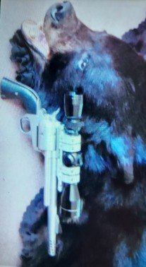

little decrease in recoil (kick).... However, after I had an accident with my right wrist and after shooting my FA`s 454 the wrist would swell up. I then sent the 454 to Magnaport where they installed their brake. I would say there was a 40% decrease in felt recoil cause my wrist no longer swelled up.... That`s a picture of her with the brake.....![[image]](images/uploaded/202512090902586937e5c2b3568.jpg)

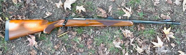

This is my cherished .416 Rigby with the brake. Gary built it for Kase and their African trips. It's been at least a couple calibers before the .416 Rigby. Compared to my .375 Winchester. The shorter barrel reduces performance some and that brake does the rest. I'd say it's less than a .300 Magnum as to recoil.

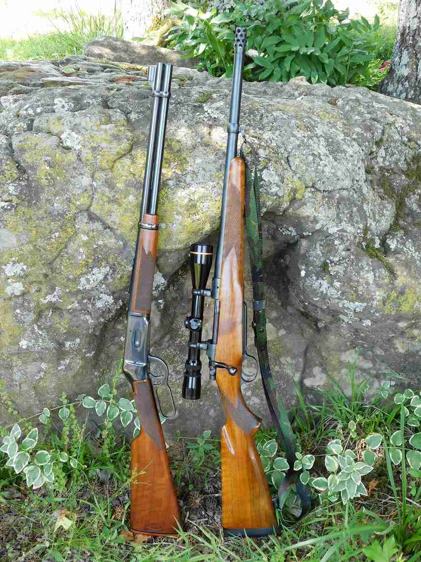

My .458. I had the barrel shortened to 22" but the brake is 3" so from a 24" factory barrel it is still LONG. I sure wish I'd had it shortened to 20" + brake. But it really helps recoil. The inertia is still there. All this applies to revolvers and single shot handguns as well, conceptually.
