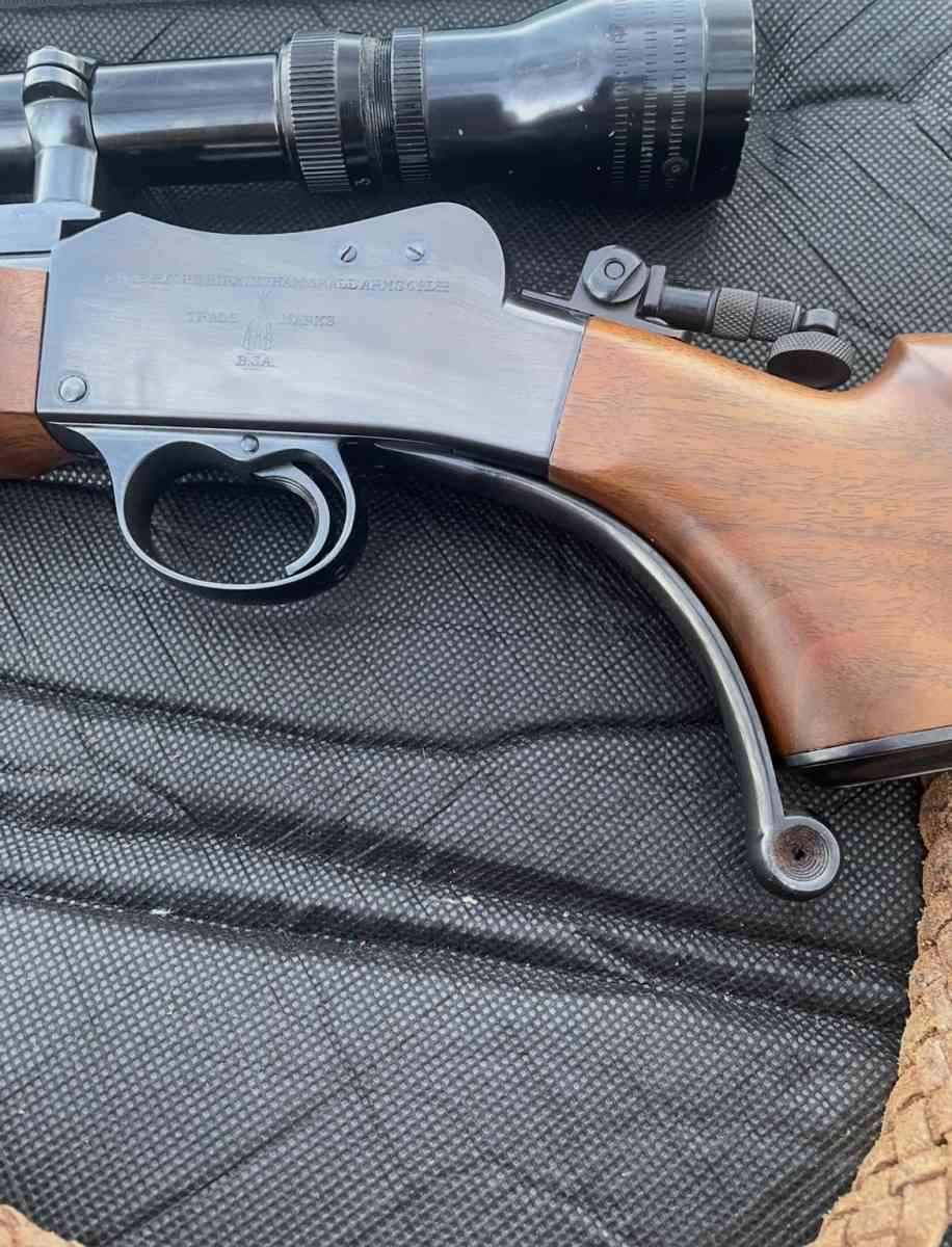

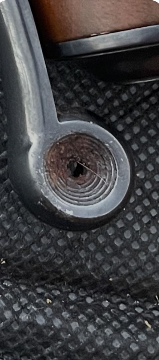

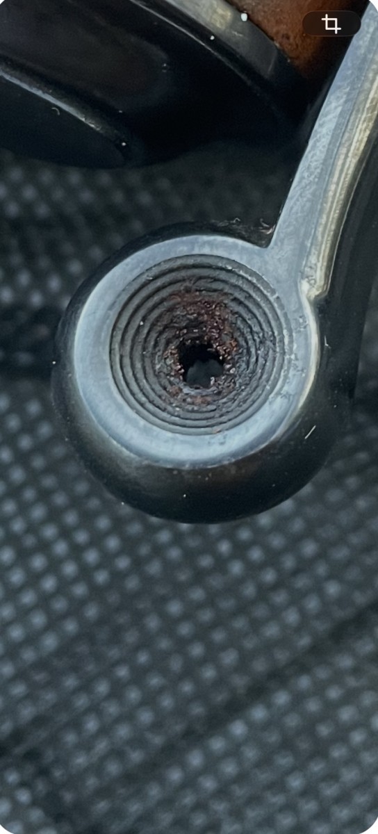

I have this blued part, it won’t stop the salts rusting
Saturday, January 24, 2026, 12:04 (276 days ago)

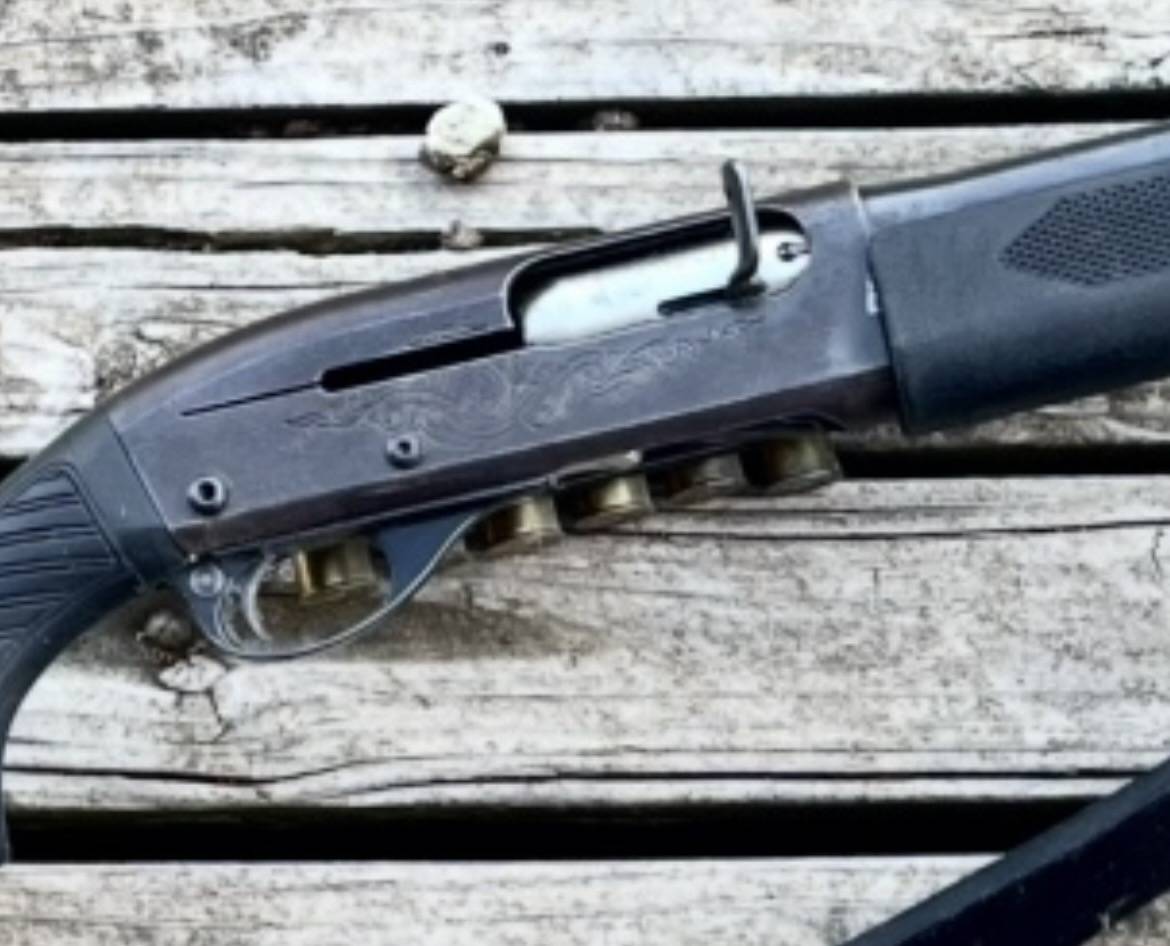

I’ve soaked it many times in several types of oils. It still sprouts little barnacles of oxides. With time it always comes back. I thought about drilling it out and reforming to a loop. Maybe that would help. I also have an old Rem. 1100 receiver that has turned patina. Perhaps a flat blue would fix it all.
Bead blast the piss out of it. Then blue it
Sunday, January 25, 2026, 18:26 (274 days ago) @ WB
Or I have sent parts to the companies that does the silver coating and never had them rust again.
