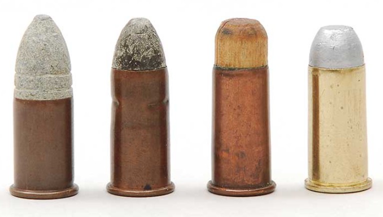

It looks more tapered, but several cite making them from .348 or .50-70 cases. Starline is making the brass in limited numbers. I just wondered if anyone knew about the dimensions.
It looks real close. Same .51 bullet.

The original for the rifle probably was the
Friday, February 06, 2026, 16:19 (263 days ago) @ WB
round on the left but if they are running some brass I would bet it was the round on the right due to the strong rim and the sides of the brass.
Yeah the one far right is centerfire, rest rimfire.

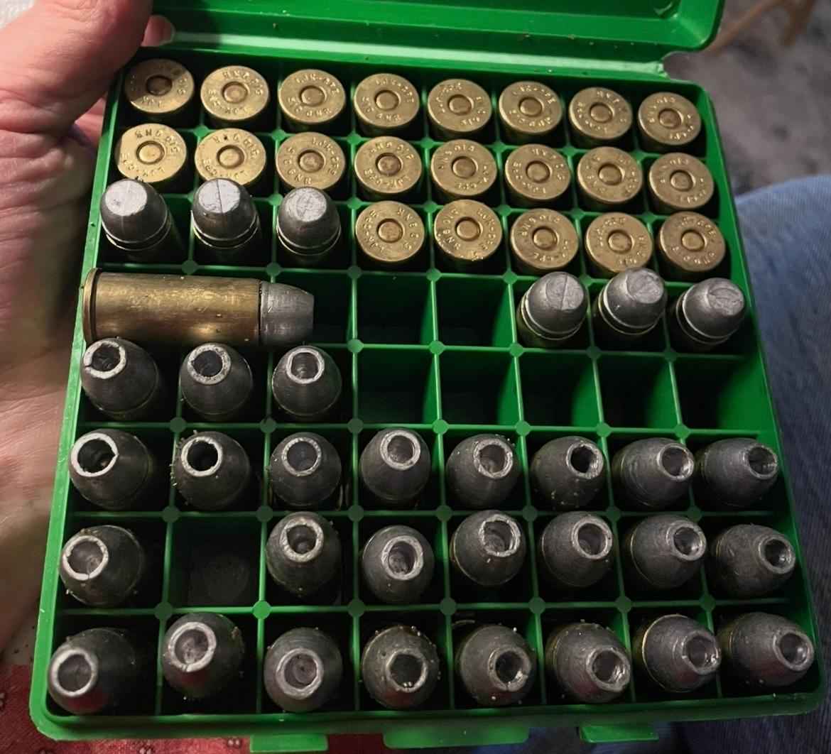

Shoot, my calipers are at work. Crudely
Saturday, February 07, 2026, 19:45 (262 days ago) @ WB
I'm showing the Spencer brass 1.5mm or so shorter. I get about 31mm for my loaded .510 GNR ammo and the Spencer says 29.5mm. Not a problem. The rim diameter is a little more difficult to measure with a ruler but it looks like the .510 GNR is 15mm or so and the Spencer specs. say 16.1mm, again about a hair.
There are other dimensions in play but it's close enough to get some and just see. I have made .510 GNR brass from the Linebaugh, Max., .348 WIN., .50 AK. all work fine.
