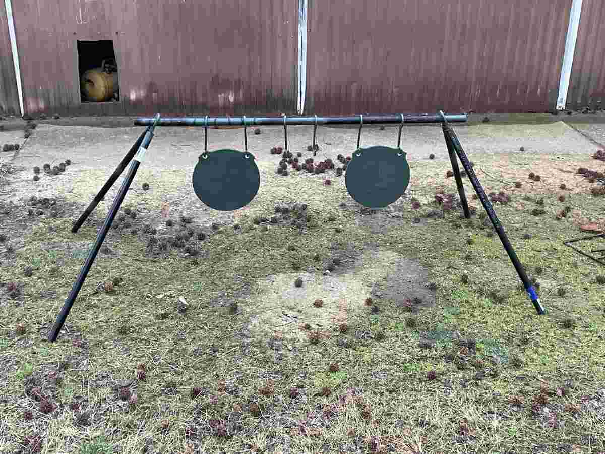

Small and simple pipe brackets. Only $27 delivered and laser or CNC cut from A500 steel. Two end brackets and six swinger mounts. I bought a 10’ stick of 3/4 I.D. Steel black pipe and cut at 6’, used the 4’ as a cross bar. Cut the 6’ in the middle and bought another 6’ for two more legs. That was $50. You could use electrical tubing to save a few bucks but I think a .22 will bounce off the steel pipe. It’s instantly portable too. I have two 3/8” thick 6” A500 swingers already. One more to have a good array. I use (4) 55 gal. plastic drums filled with dry sand as a backstop and bullet catcher. I’m hoping it will last a while.
*Yes, it’s sweet gum ball season, never ending source of thrills walking.
![[image]](images/uploaded/2026030502053269a8e4eca7367.jpg)
Something for the range… to cheap not to buy.
