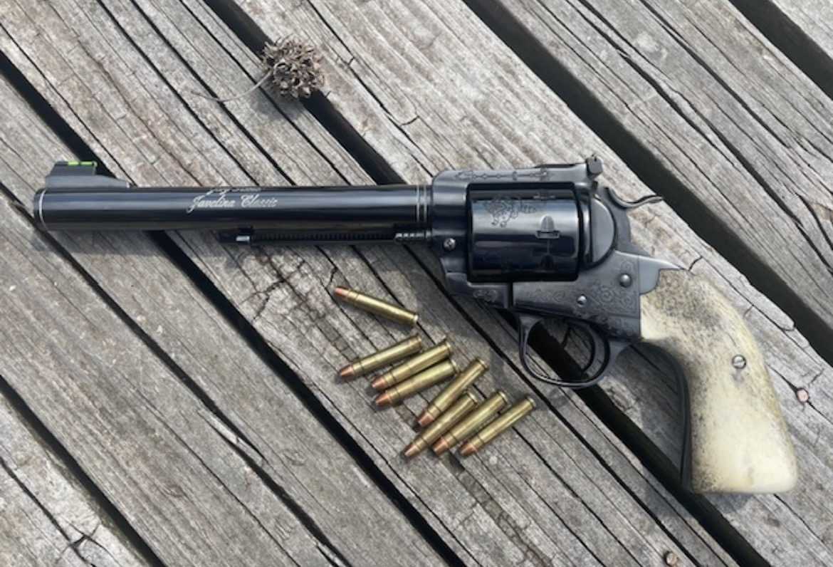

I have a 8-shot .255 Revolver. It’s fantastic. Just keep the cylinder handy setting up your sizer. Push the shoulder back far enough you get full seating in the chamber to the rim. This ensures smooth rotation.
