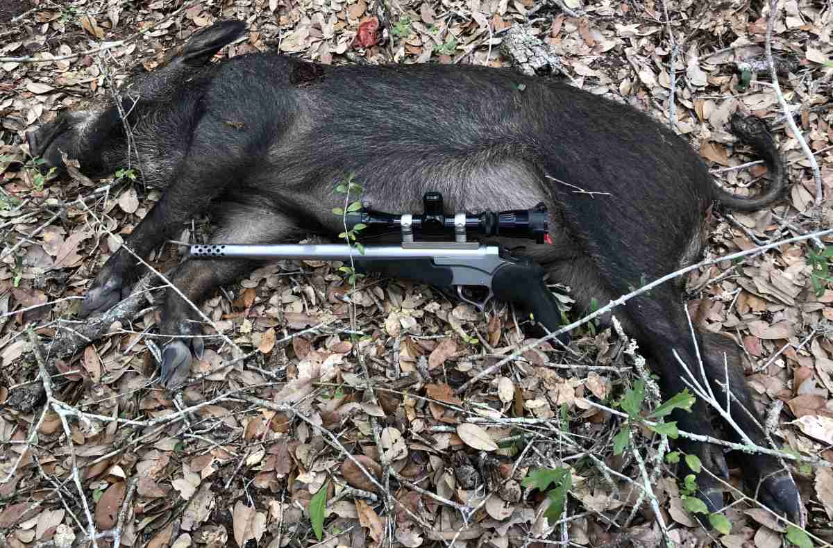

Thank GOD , I got to go pig hunting to my
Sean Harper
Wednesday, April 29, 2026, 08:21 (179 days ago)

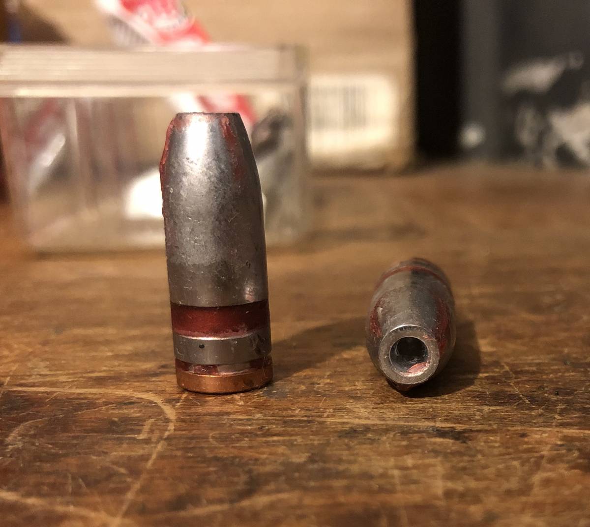

friends land in Hallettsville, Tx . He has 32 acres, took the 378 GNR with a 260gr CAST HP bullet . I bought the mold from Noe Industries . I could not get the WW alloy bullets to shoot very well , probably to soft, so I went with straight linotype and the bullets shot 1 1/2" at 50.

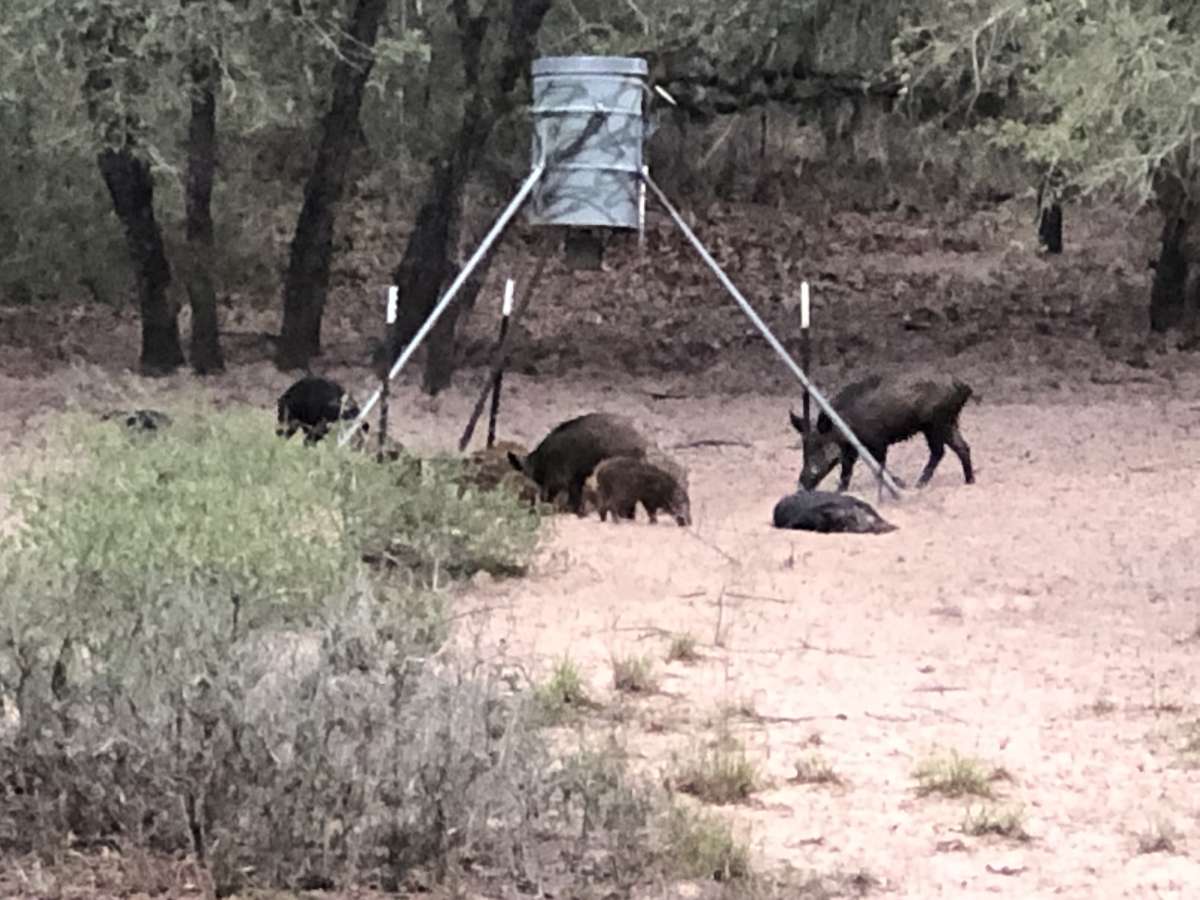

I setup a corn feeder at about 60 yards. A group of little ones came in early and then 2-3 mom's joined them and then a few 40-60 lb'ers came in last. I shot a 60lb'er in the shoulder and it dropped. Funny thing is the little one's ran about 10 yards and stopped and then came back and started eating again this eventually drew the moms back to the feeder. and the ate all the rest of the corn and then walked off into the brush

I went with Reloder 15- 53.5gr= 1975 fps which is plenty for a hog at 50 yards . I did try 3031 which shot OK but I did not want to use up all my IMR 3031.

Yes indeed,I have plenty of lino and they perform well
Sean Harper
Wednesday, April 29, 2026, 11:04 (179 days ago) @ WB
enough for hogs, deer on the other hand they would blow right thru (no expansion).I do have some surplus powders I can use.
