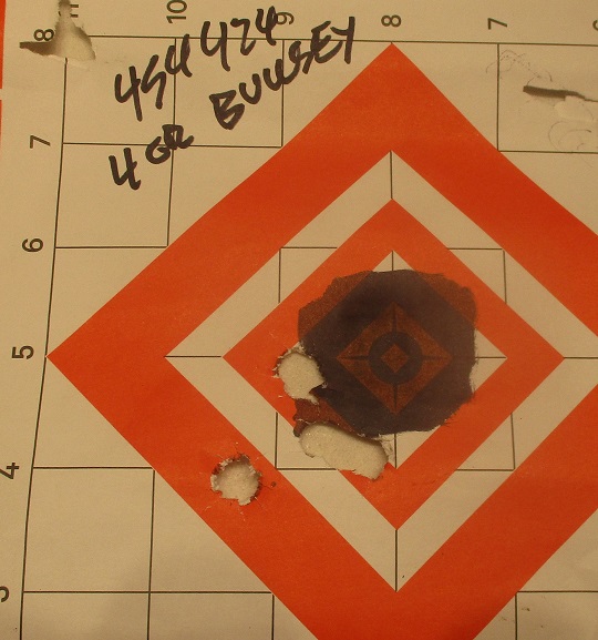

The 4 gr. Bullseye load is fun and fairly accurate in my gun. Sorta like shooting wadcutters in the .38 Special.
20 yards
