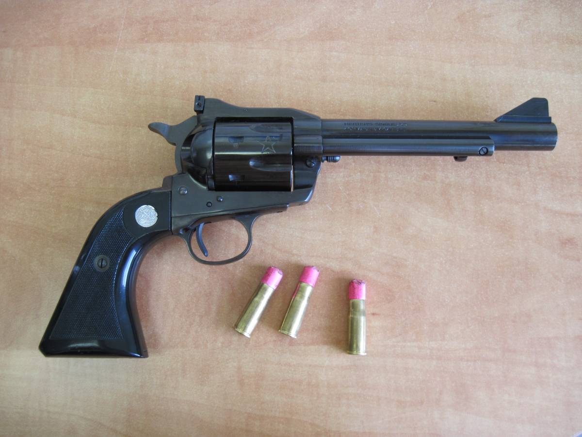

It predates the .41 Remington a couple years. Norma loaded the ammo. Making the cases from .30-.30 is a bit laborious (rims too big and thick) so I use special lathe turned .41 REM and .40 S&W dies. Trimmed to 1.27” as the old gun requires. It’s basically a rimmed version of the much later 10mm Auto Magnum.
From my experience all the rounds you mentioned are no more robust than the common .30-30. I’ve made .375 and .225 Win. from .30-30.

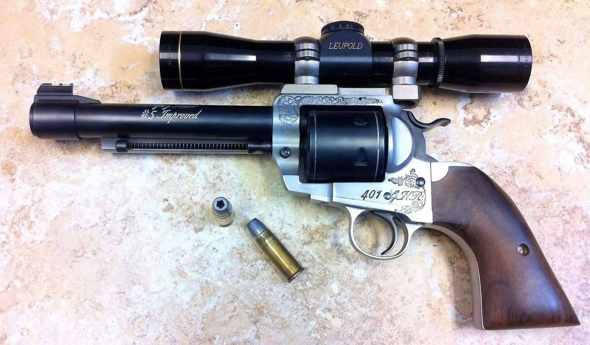

The Herters round was ahead of its time, a real in-the-middle .400 round. Better filled the .357 and .44 (actually .43) gap. A boy named Lee Martin did one too, a little longer, but arrived at the same place. Gary’s .401 GNR gets there lots easier, .44 Mag necked to 10mm. A little brother to the .410 GNR!

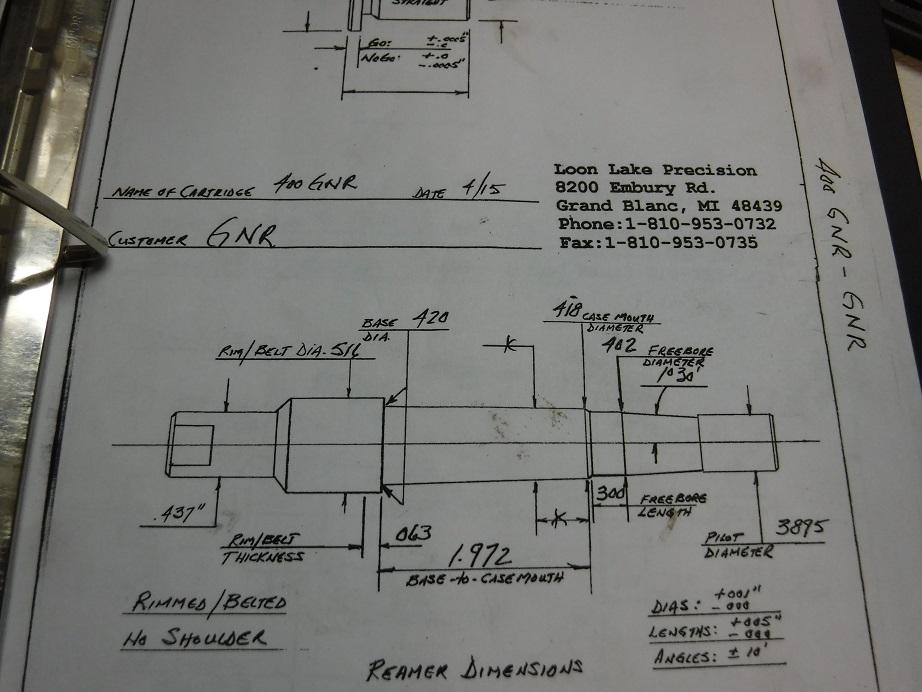

Look over this drawing and see what you think. I find the conversation very interesting. I am considering reworking my chamber to what "I" think it should be. If I ran a 10mm "magnum" reamer into the chamber to the chamber mouth it would change it to 0.423" mouth - 0.425" base. Still tapered but big enough to handle most varied .30-30 brass thicknesses. Since it is made world over the dimensions do vary wildly. Rim thickness too, but that is another story.

I tend to agree with you re: the taper and wall thickness.
Below are the drawings for a set of reamers that I had Manson make me. They were to allow me to ream a spare 686 cylinder to 10mm magnum for my 686 and also use 30-30 brass with its extra thick rim as a sort of 10mm magnum auto rim.
