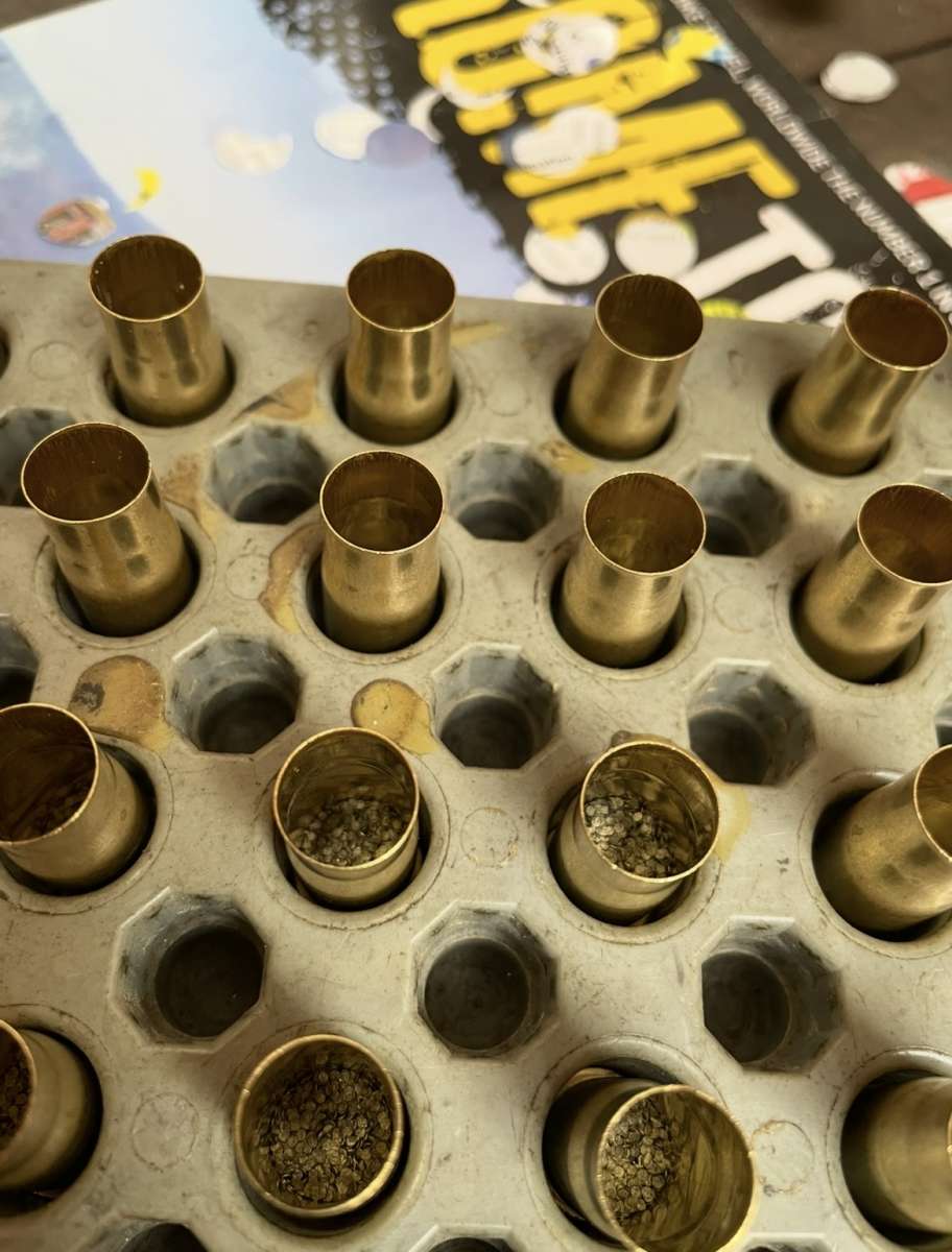

Middle right case has 9.0 hrs. Bullseyes, left and others 4.5. But a lb. Of Bullseye will load over 1500 rounds!

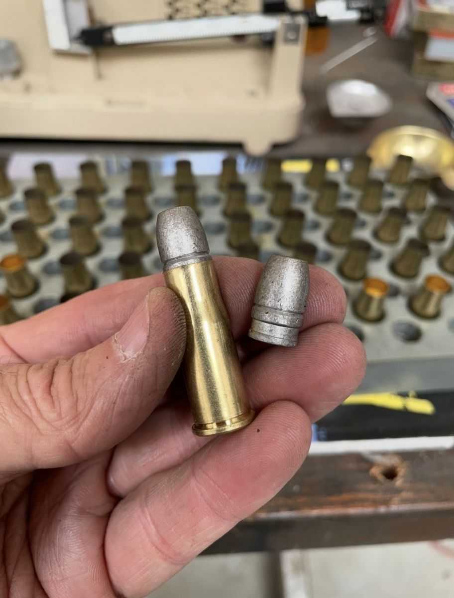

Real easy to bulge a case crimping. I actually crimped a case screw adjusting the die.

Not much bullet pull in the case but it should work.

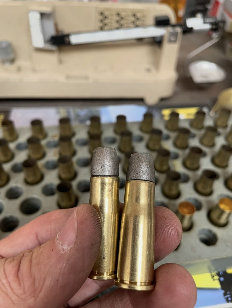

The old rounds look the part and a bit exotic. I like the 10mm bullet and shoot .401 GNR, .400 GNR, .401 Herters, besides the .40 and 10mm. Gary has me two full customs, a G2, and a custom .38 WCF cylinder for my Herters Supermag.

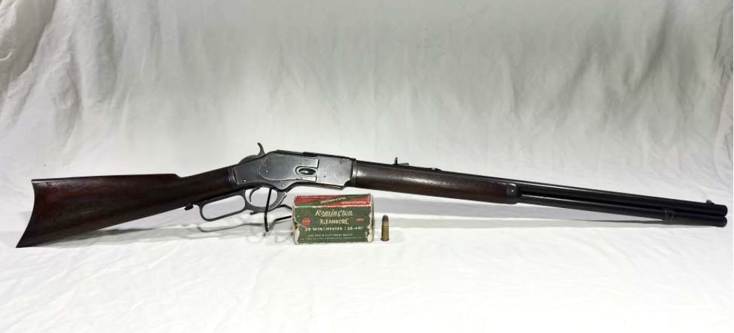

I hope the 140 yr. old Winchester will still shoot.
