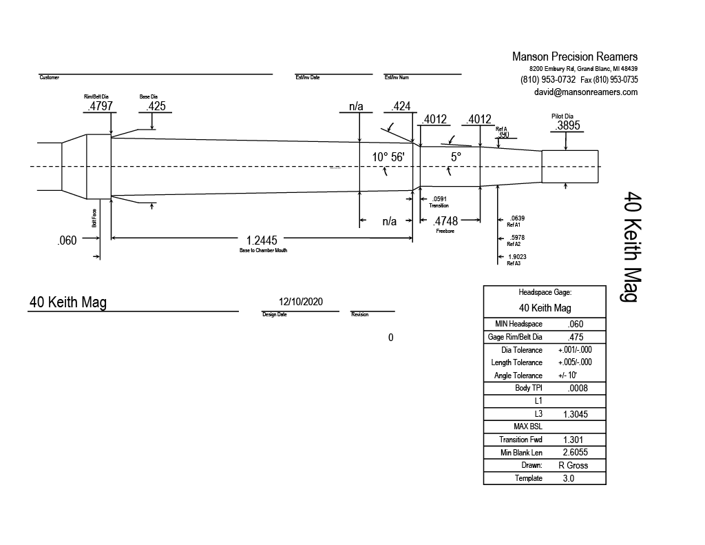

Below are the drawings for a set of reamers that I had Manson make me. They were to allow me to ream a spare 686 cylinder to 10mm magnum for my 686 and also use 30-30 brass with its extra thick rim as a sort of 10mm magnum auto rim.
![[image]](images/uploaded/202605160316066a07e176a8c32.png)
400 GNR - Short?
- Keith, 2026-05-11, 18:42
Yes, it’s called the .401 Herters Supermag
- WB, 2026-05-11, 20:55
No, not quite
- Keith, 2026-05-12, 18:37
I think the .400" is too big for a .30-30, .225, whatever
- WB, 2026-05-13, 13:10
- Agreed - Keith, 2026-05-15, 20:22
- 401 GNR #2- 445 SM necked down (nm) - Sean Harper, 2026-05-12, 04:34
No, not quite
- neck ream - AlanT, 2026-05-11, 19:19
