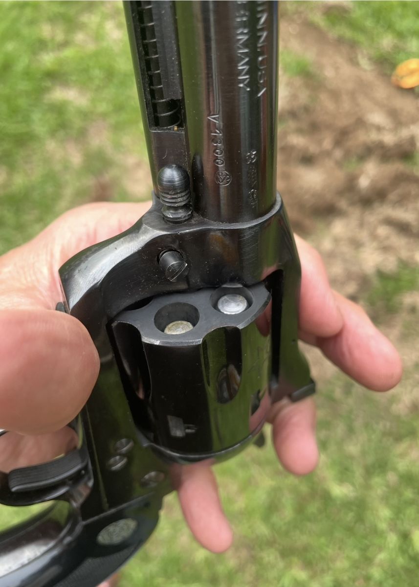

I broke out the sixguns too, just to see. They ran a sedate 635 fps! 315 fps average slower than the rifle. Even with so fast burning powder. I did note unburned flakes with the long seated rounds. The only one I had left, long seated, ran only 517 fps from the 6-1/2” Herters .38/40. The cylinder was plenty long for the overly elongated round which could come in handy. Won’t mix up the rounds for the rifle. The Reeder Ruger custom has a shorter front to back length cylinder but unlike the recessed case head Herters, its exposed rims allow the same OAL.

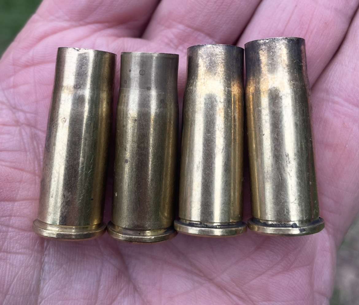

I note the difference in modern revolver chamber shape. The rifle on the left, like many older .38-40 and .44-40, has a more tapered shape. Fired brass has little left of crisp shoulders. I’ve seen this quite a bit. No problems though.

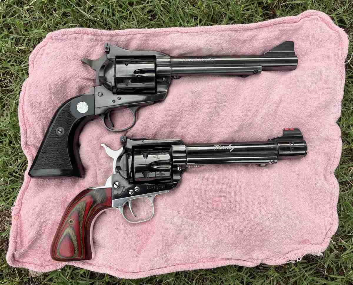

I don’t speak much about the custom .38/40 six-shooter but it is one of my finest. It’s built on an OM .357 chassis that has the transfer bar added. The only converted one I own. As you might imagine with the large chambers bored out it’s light and lively. But Gary added a heavier barrel with front sight band. The added weight holds the muzzle down in recoil and really settles for sighting. I would like another 10mm cylinder for ease of ammo sourcing. It’s a really fine gun with shield reliefs and Gunfightered grip frame. Even drilled and tapped for the future and my failing eyes. A bit flashy, festooned with custom cattle brands. They have a unique special meaning to me. Hidden initials of hunting friends and destinations. What a wheelgun.
