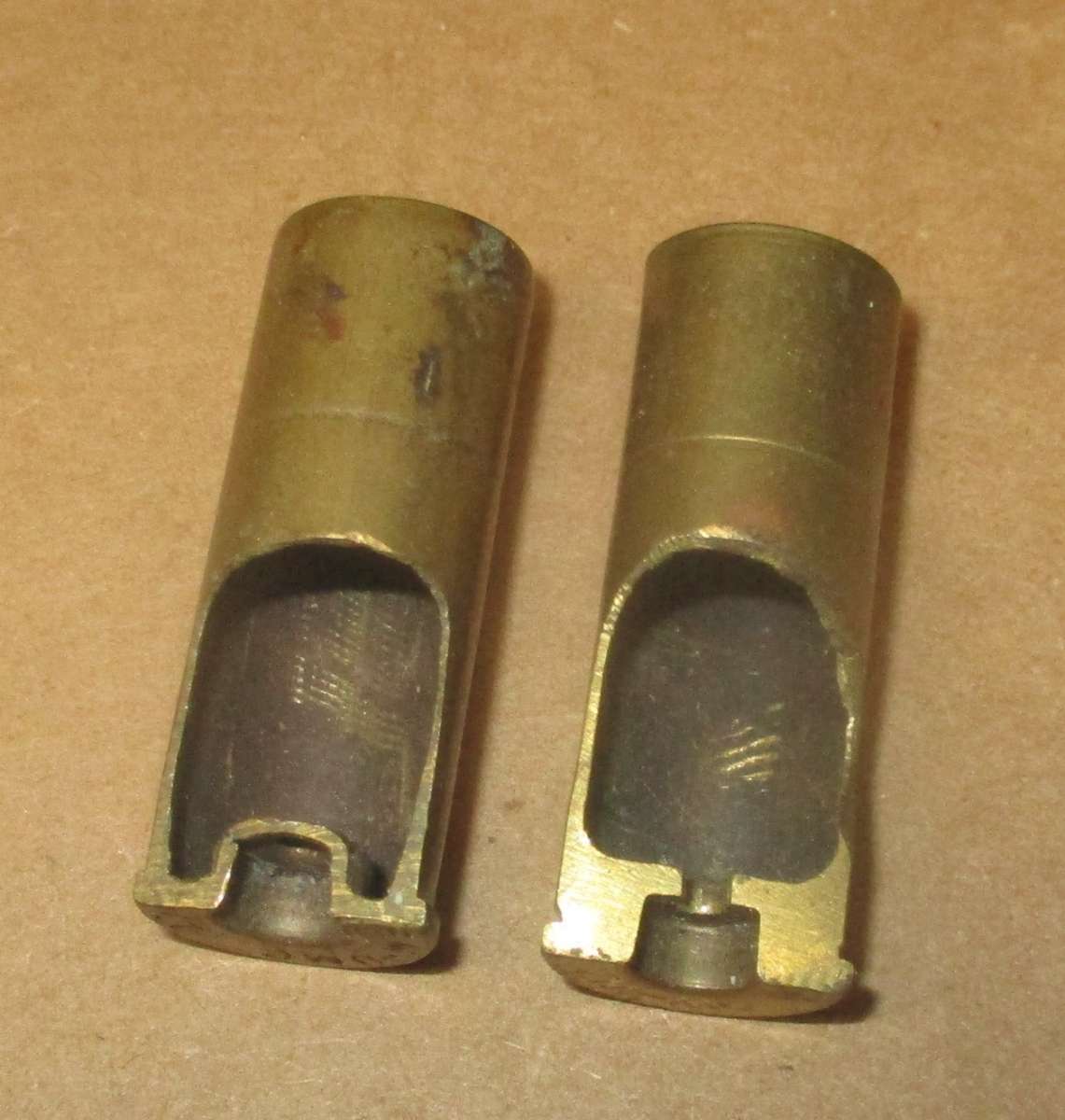

The original factory loads were pretty powerful. With an advertised bullet weight of 250 gr. at a velocity of 910 fps, it created over 460 foot pounds of muzzle energy. I once re-created those loadings using original REM-UMC balloon-head cases and 40 gr. of Dupont 3Fg blackpowder. I used the Lyman bullet #454190 which is a faithful reproduction of the original factory bullet except it is not hollow-based like the originals were. In my 7 1/2" Ruger .45 these loads averaged 962 fps and produced a muzzle energy of 532 ft. lbs.! No wimps by any means.
L-balloon-head R-solid head (modern)

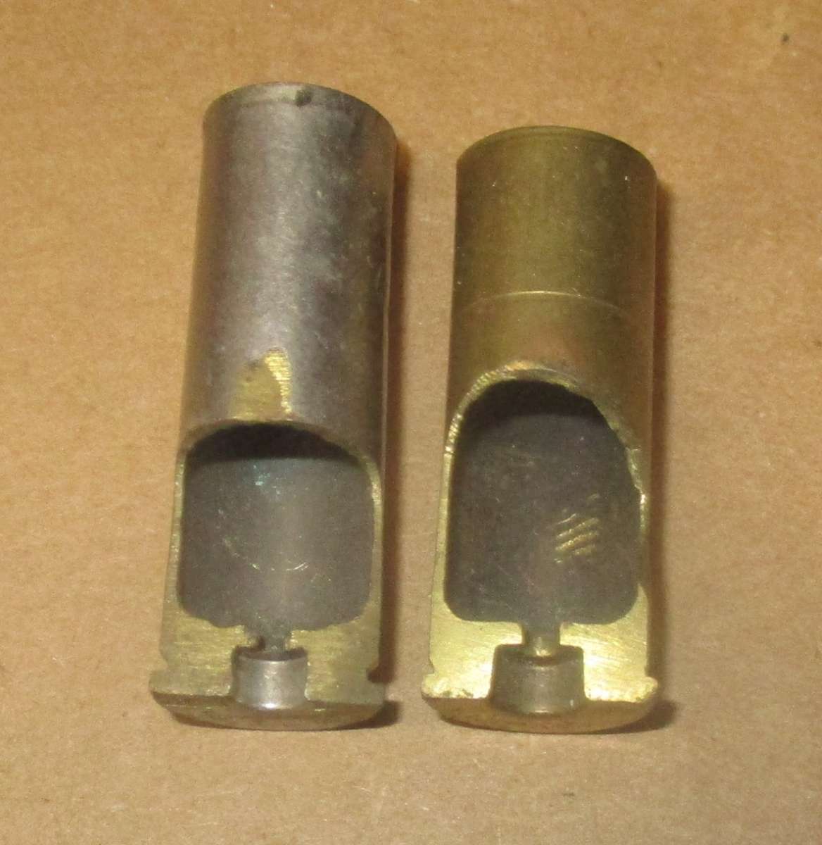

When handloaders started pushing heavy bullets from the .45 Colt in the big Ruger single actions there were all kinds of warnings about weak .45 Colt brass. It wasn't true and a few of us proved it to our own satisfaction. When the 454 Casull appeared the 454 brass was hard to get. A lot of us who were shooting them used regular old .45 Colt brass and loaded them to 454 pressures and velocities without any problems. If you compare sectioned cartridges there is no difference other than overall length. If you have a .45 Colt sixgn with tight chambers, the Colt brass will last many reloads. I have recorded more than 20 reloads with R-P cartridges (which at the time were rumored to be the weakest) fired through my tight Linebaugh .45 Colt.
L- 454 Casull R- .45 Colt
