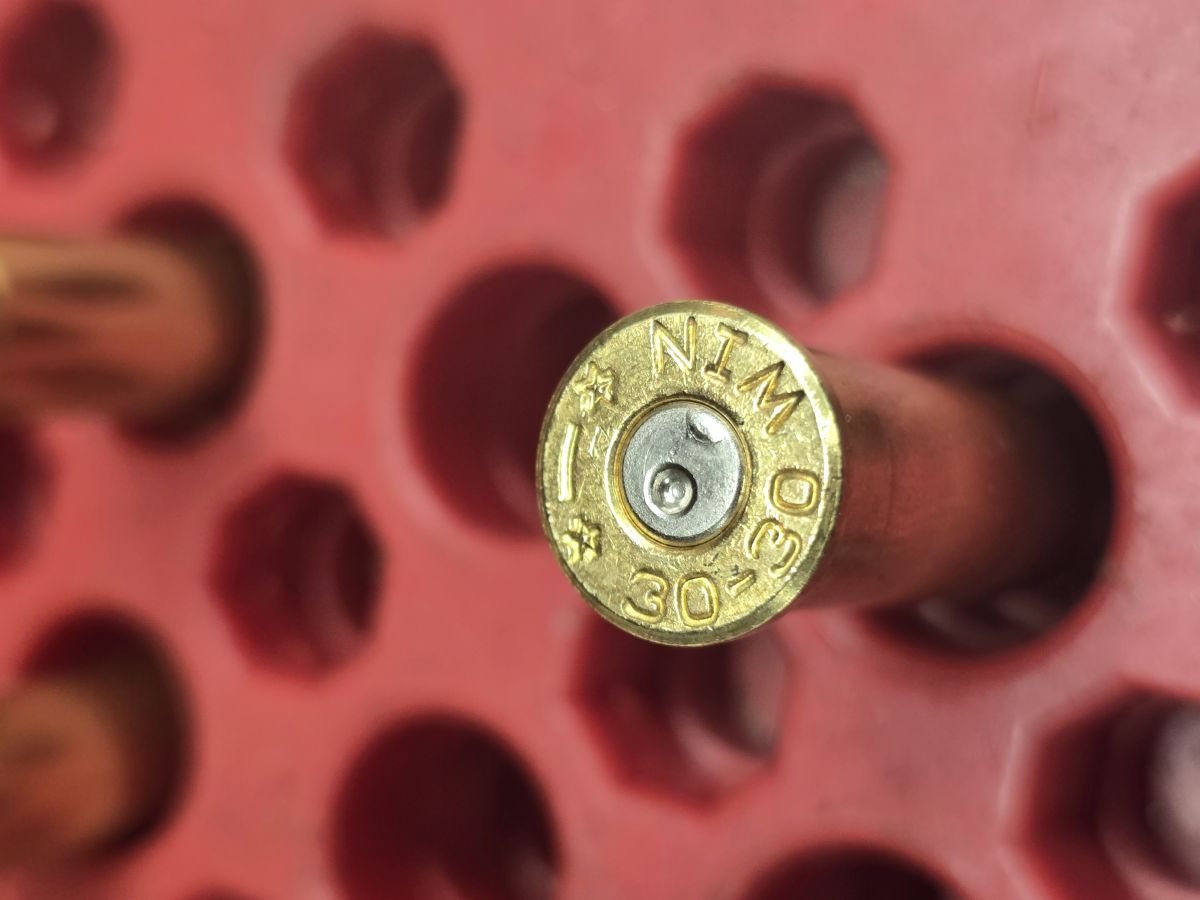

Been having pressure issues with my 256 falcon. Talked to Gary about it last fall and finally got around to trying things. New brass, 33 grains of 2230 100 grain speer hotcore bullet, standard large rifle primers. Does this primer look flattened?![[image]](images/uploaded/202608160006356a80ff0ba88f4.jpg)

The edges of the indentation are just crisp.

Pressure

I would dump that piece of brass with the

Off center hit
