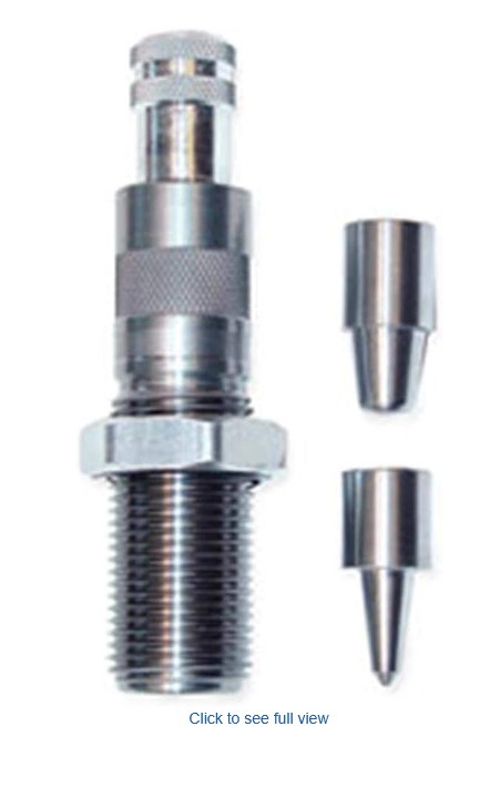

I might make me some "expanding mandrels" on my lathe to insert into some odd Lee expanding dies. It's not really made for that but it would be handy to use as a concentric holder, and easy to make mandrels to fit. I have to measure the ID of the die body too.
