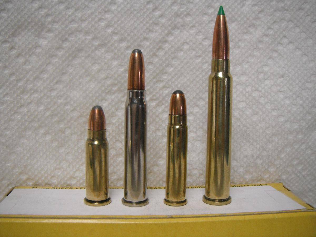

the 30 GNR is the one that is fireformed in a 30-30
Friday, August 04, 2017, 13:02 (3285 days ago) @ B Kilburn
chamber. The 300 GNR is a revolver cartridge and is shortened down to about 1.35 or so. In the pic..300 GNR on the left, 30-30 on the right.

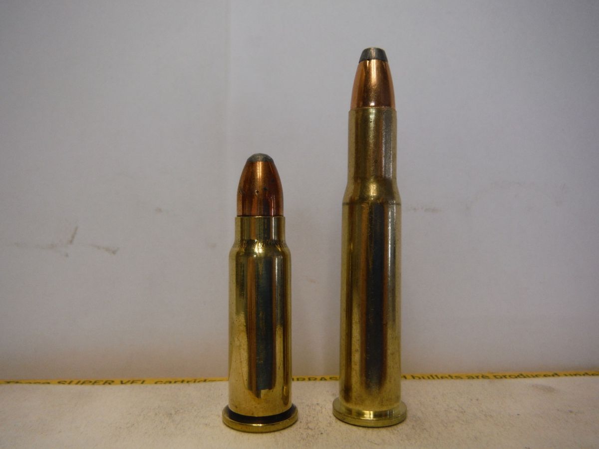

In the second pic left to right..300 GNR, 30 GNR, 307 GNR and 310 GNR.
