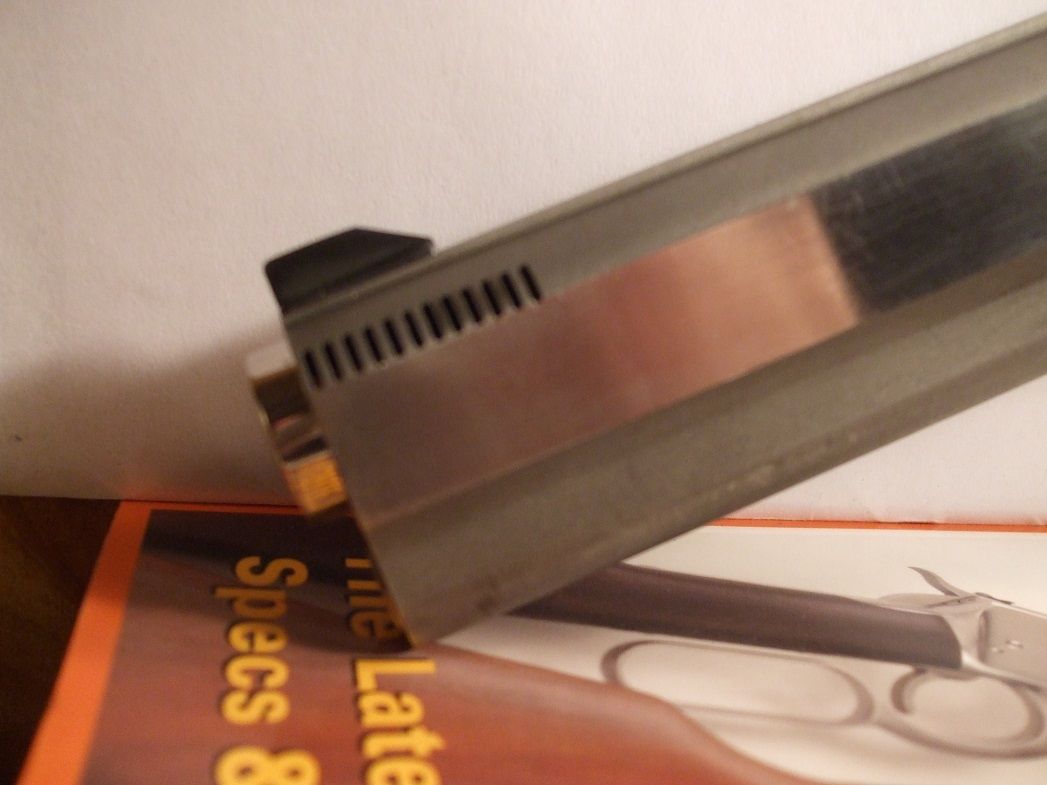

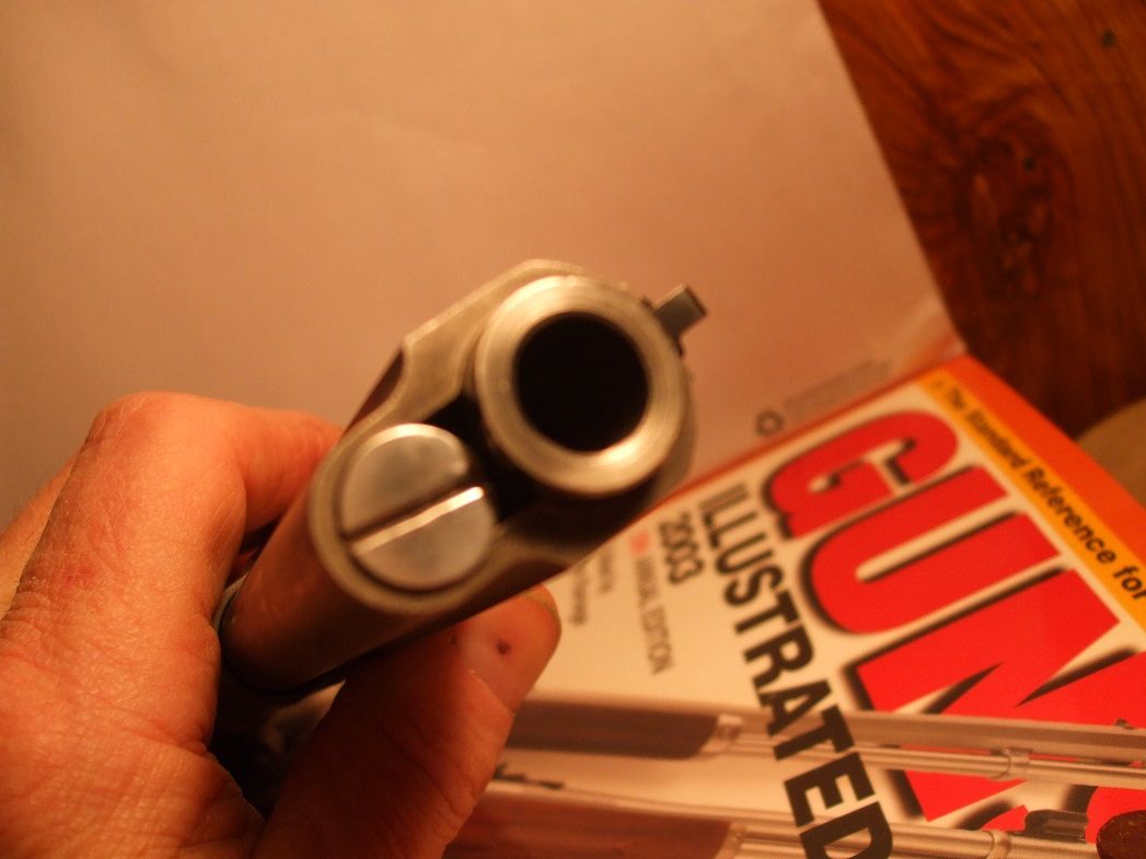

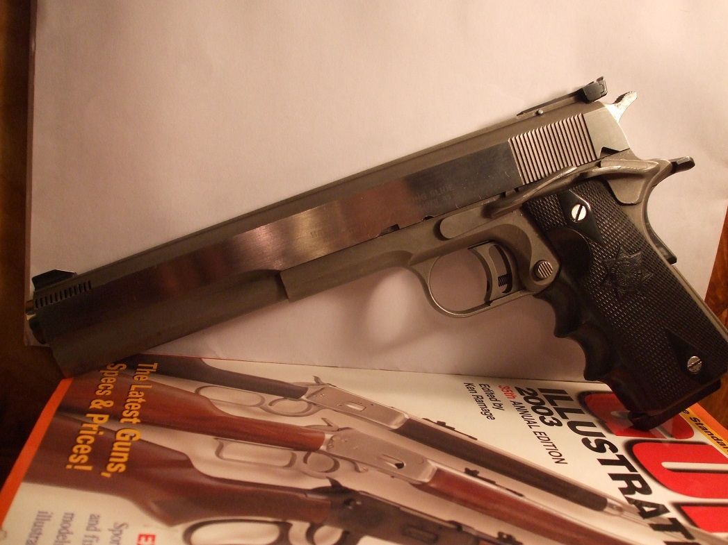

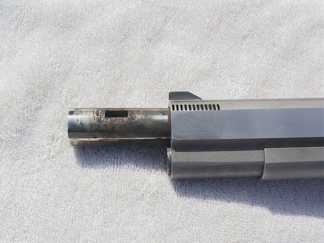

here is mine..
Wednesday, January 24, 2018, 23:47 (3215 days ago) @ Gary Reeder
I would go looking for another one, but
