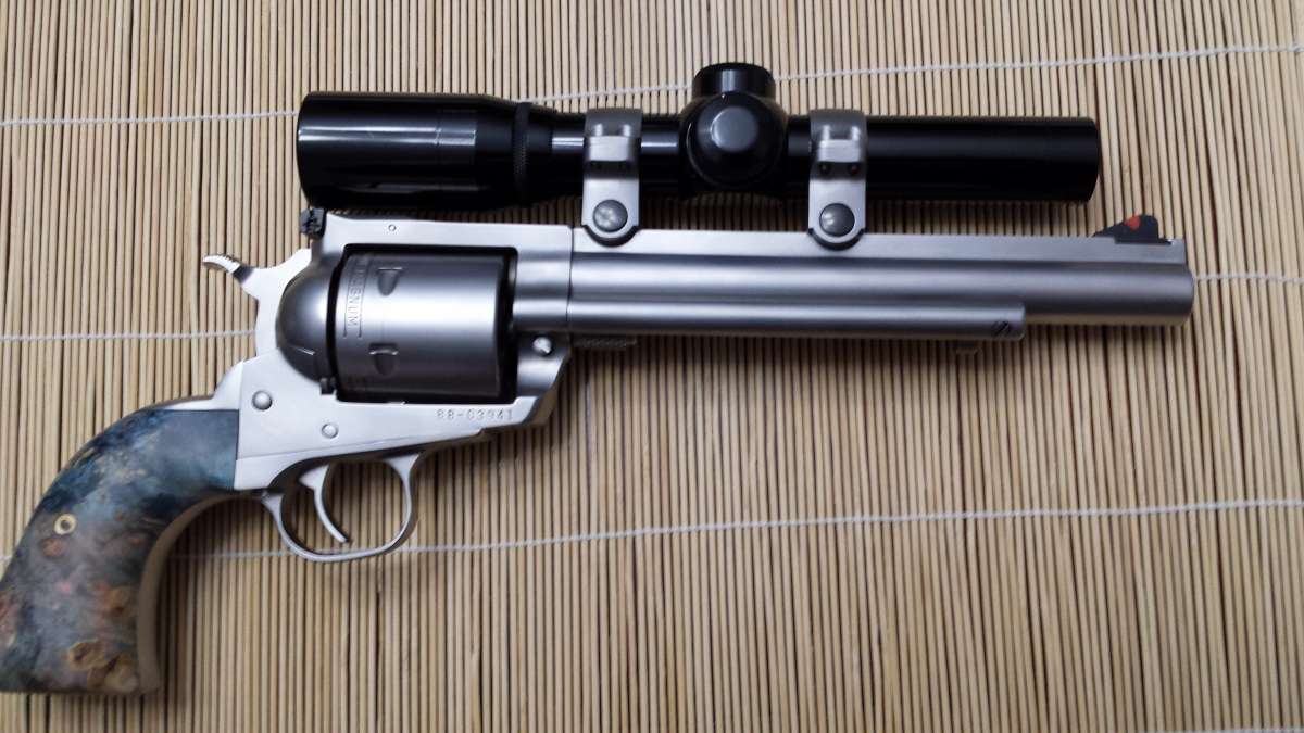

Just got this one back yesterday
Amede
Thursday, February 01, 2018, 18:19 (3208 days ago) @ WB
PPP package, refinish, and added the belt mountain base pin. I also just put on the custom grip frame I got earlier.![[image]](images/uploaded/201802020118515a73bc7b6fe29.jpg)
