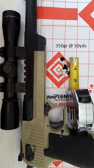

Desert Eagle 10" 50AE
Coloradoyaler
Sunday, February 04, 2018, 17:22 (3205 days ago) @ WB
Not much difference. I am sure you guys can name the other two. With my 10" barrel it is not any bigger than the Encore. Heavier maybe a little. Trigger not as good but you get used to it. The 10" inched scoped will do easy four inches at 100yds with a 350gr @1550fps and the 6" with a red dot and a 350gr @ 1350fps will do an easy 6" at 100yds.
